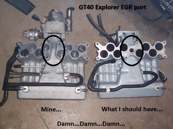

You have plans on upgrading the TB and EGR spacer? You'll get more from the intake swap if you upgrade to a bigger TB/EGR.
how can i tell if it has an internal egr?
You can use either one. Left one will just require you to render egr non-functional.
One on right will have matching round port on lower intake as well
