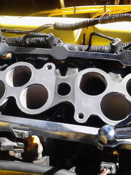

The lower intake bolts were a bit loose. But I believe I found the problem. Im just not sure what to do about it.
. the upper intake splits to eitherside instead of blocking the hole in the center??
Thnx Kurt I threaded and plugged it. Now me and the bbk cold air are arguing. With the MAF plugged in it runs but no power. Unplugged it runs badass. I had to switch the MAF module off of my MAF on to the one on the BBK. I'm not sure what hte problem is though.
