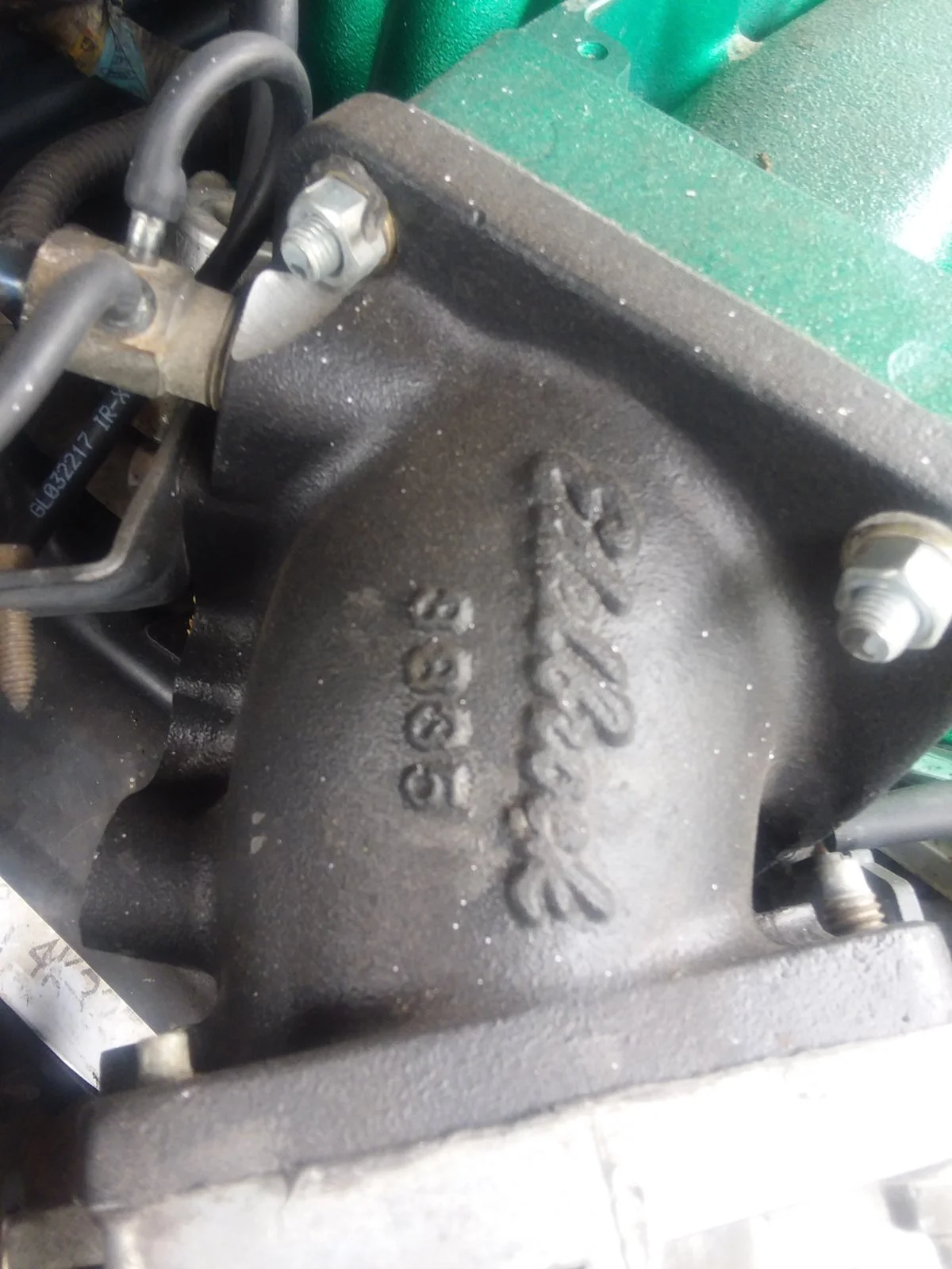

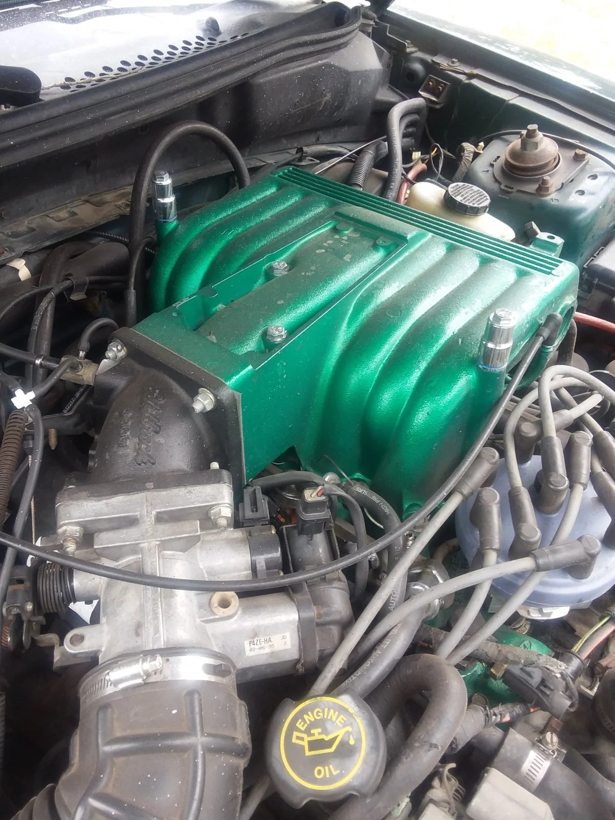

Yes the adapter will work I have one on my 95gt it's the edelbrock adapter and works great
