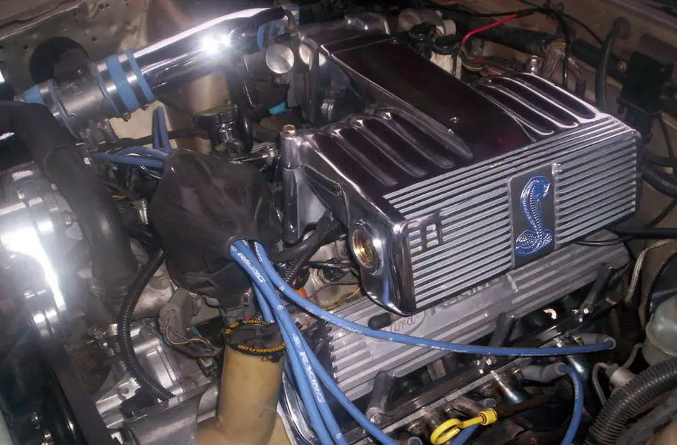

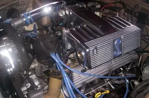

Here's my Explorer intake after I worked it over.Did some beautification work and I like it.It's my "One of none" Cobra intake.

mine is from a '96 Explorer.They can be found really cheap.I got mine for free.Well,I traded a T-Bird headlight harness and some headrests for it.May as well have been free.
