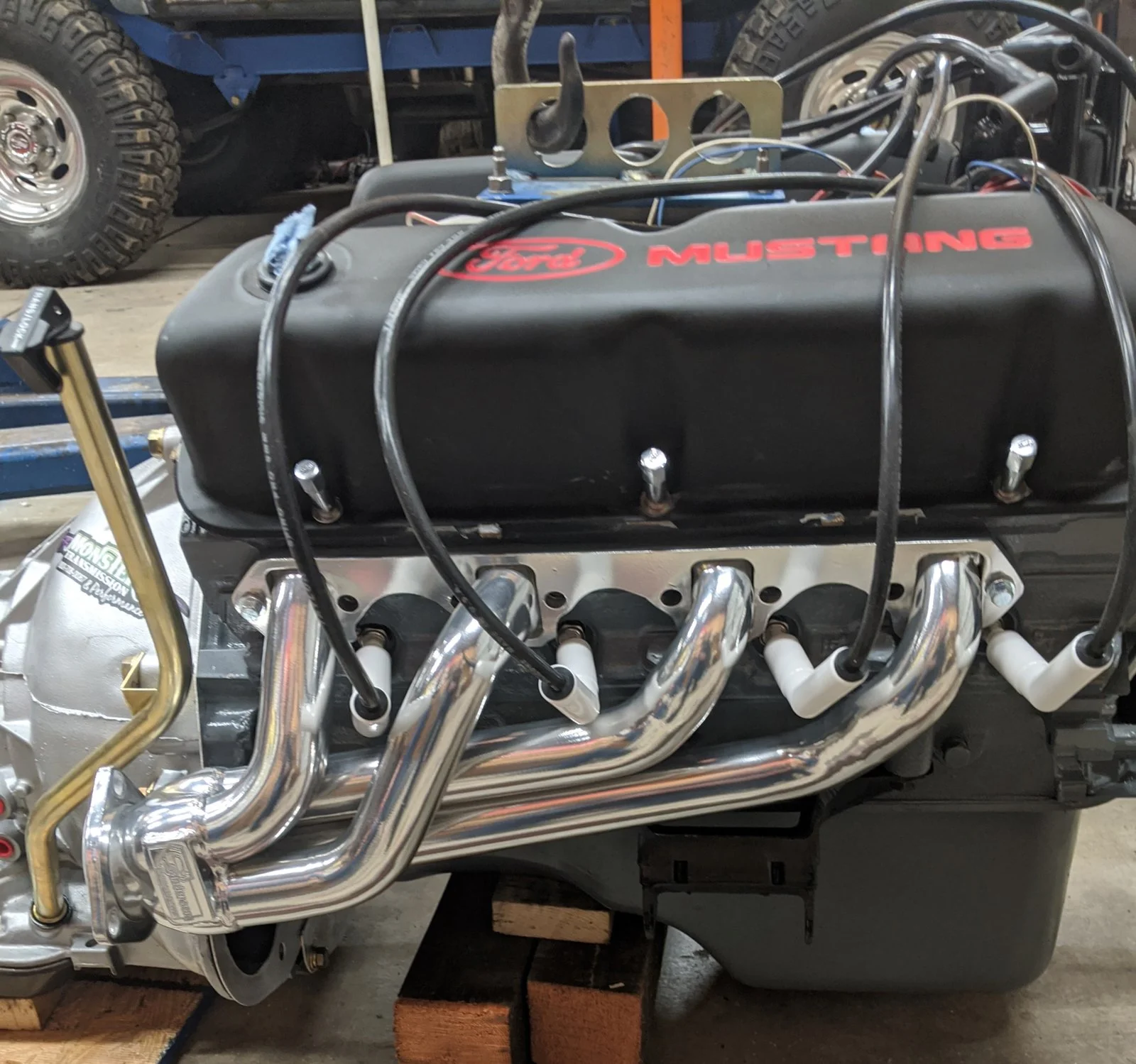

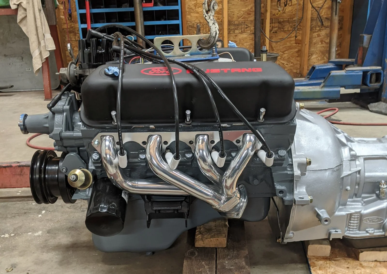

I hope this helps somebody, these headers work on GT40"P" heads and with a AOD transmission.
Sanderson Headers FF3GTS-SEC
After so many fails and time, I wanted to share. See the pictures.
Doug
