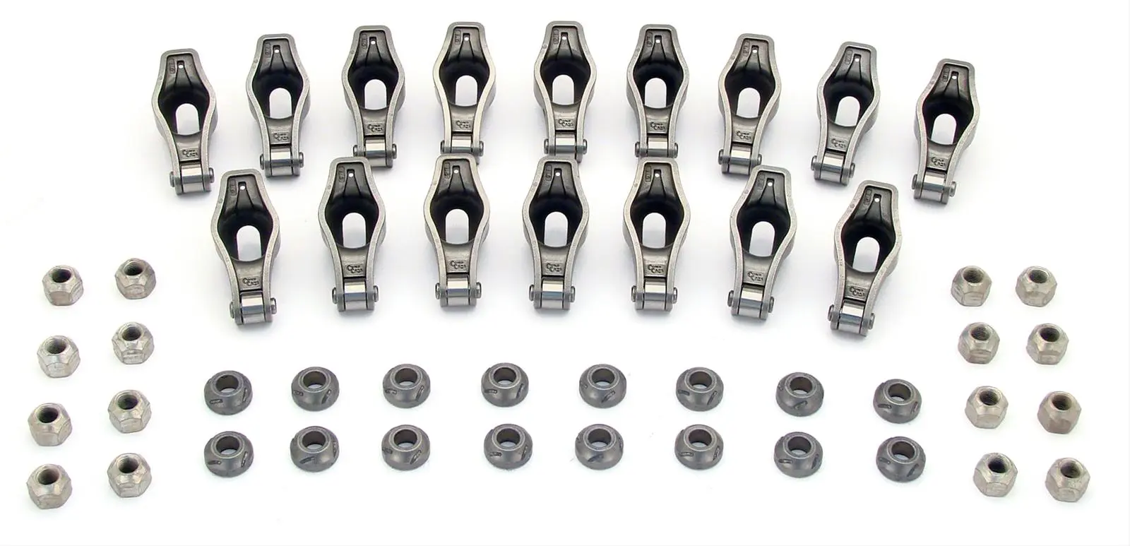

Long time reader, first-time poster and I'm seeking some advice on a rocker arm nut issue. I've been working on my '67 Mustang 289 +.030 V8 with a fairly aggressive "street/strip" cam (290/228, .504 lift), Comp Cams Roller Tip "Rail Type" rockers using poly lock nuts (some type from JEGS I bought years ago. YES, heads were machined for screw-in type studs, but no guideplates. Carb is EDB 1406, brand new out of box, and I've adjusted float level, etc.
My problem: I've been trying to tune and roadtest this beastie, but for some reason, the POLY LOCKS KEEP COMING LOSE, and not always on the same cylinder or bank -- sometimes left, other times, right. I'm confident the valve adjustment procedure and pre-load and zero lash have been done correctly (performed more than once so you tend to get good at these things. LOL!). I'm thinking of ordering a set of replacement STOCK TYPE rocker ball and nuts kits from Summit Racing. Am I just NOT cranking down the poly locks enough to keep damn rockers tight for more than a few starts? Just don't want to bend any pushrods or valves at this stage. Thanks for your input and shared experiences with this PITA issue.
