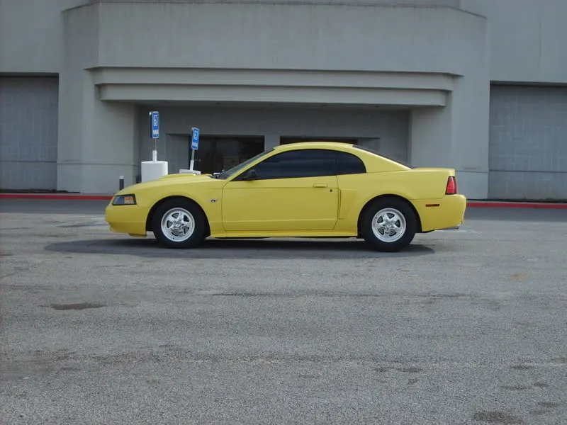

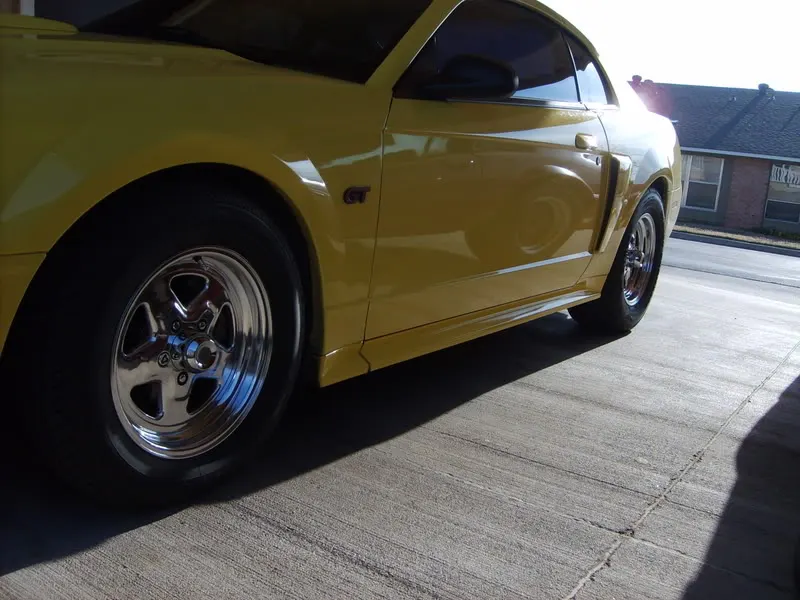

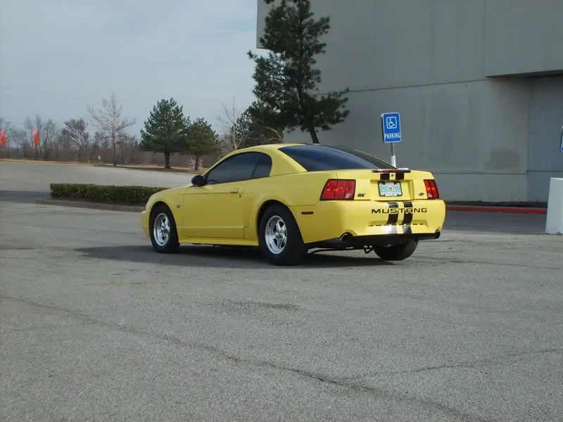

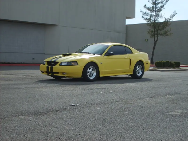

The wheels are the SummitRacing's version of Weld's prostars. 15x4 and 15x8. The front tires are Kumho 165/80/15's. The rears are 255/60/15 Mickey Thompson ET street radials.
comments welcome!
Nice! what lugs and studs did you use? I'm planning on getting Summit wheels that are like the prolites
Stock on both. The Summit wheels have a conical seat just like the stock wheels. Welds however, require shank style lugs and 3" studs(i think). I did need a 1/4" spacer up front though. They would barely rub the caliper bracket. I could prob have ground it down, but the spacers were only $10.

Edit: I weighed the fronts and they were 13lbs. give or take a lb. Rears were 17lbs.
