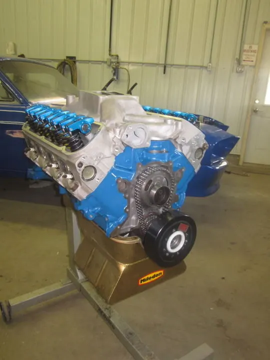

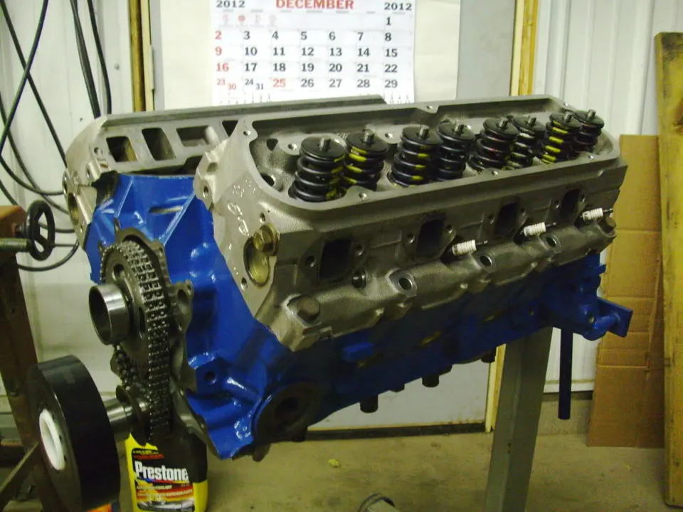

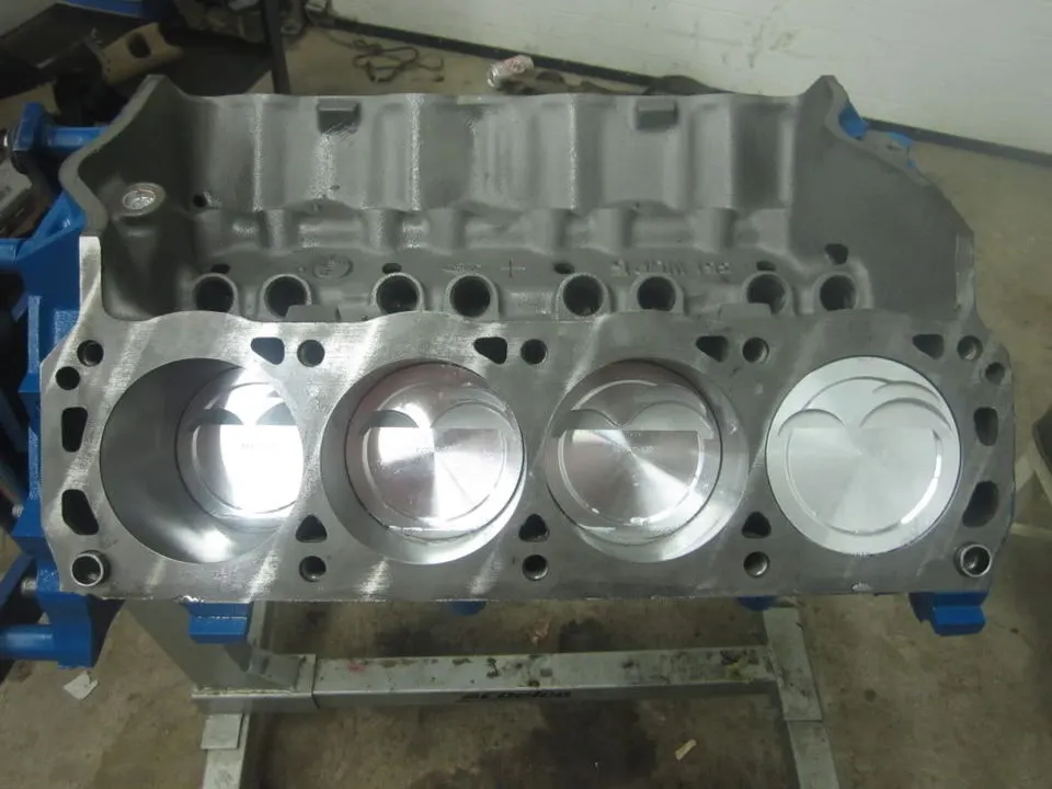

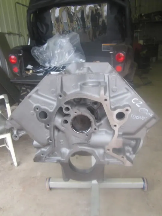

The list 351W to 393W stroker
Eagle 3.85 stroke cast crank
Scat Forged I beam 5.956 rods
Probe Forged P235 Dished pistons Around 10.1 compression
Comp Mutha Thumpr Cam
X302 Turbo Swirl Aluminum Heads
Weiand Stealth
Holley 750 DP
Hooker Headers

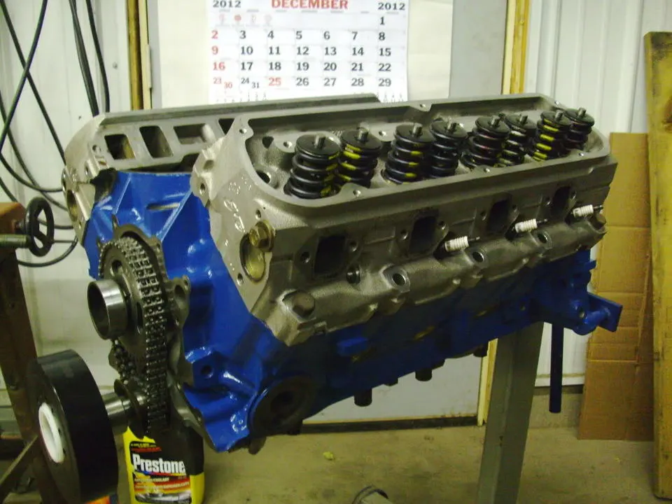

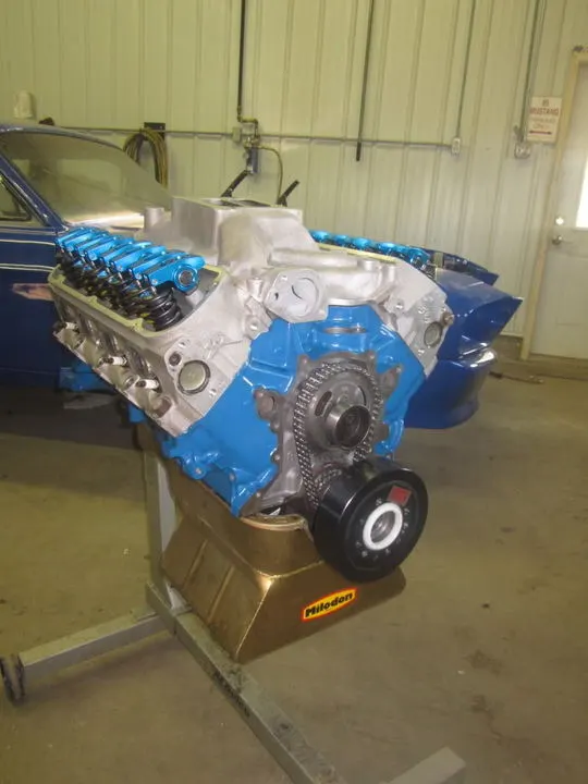

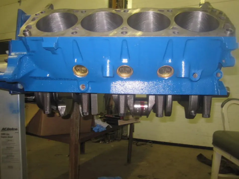

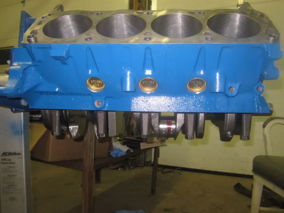

Here is some pics...

Nice truck engine -lol-
Your boyfriend come up with that one?
:fight:
He is probably right though, didn't think i needed a 408 with AFR!- heads I was wrong.
Cam Specs -
287 series/ With a tiny .501 lift, Should have done a roller block.
Just having a little fun.
I expect the smallish carb, cam and heads will provide awesome low and mid-range power. That's a decent match with the build, actually. Those stock length rods leave you with rod ratio about like a stock 454 Chevy, which is not a hi-revver. If you have an auto trans, especially, I think you'll like it.
Power should peak around, what, 5600 RPM? I'd say 430HP and 475ft-lb torque. I'm not sure the carb will feed it enough at the high RPM, but I didn't run a calculation. Make sure you have adequate fuel line/pumps to feed the beast. And have fun.
Just having a little fun.\
I was too ;) - I actually laughed at the truck engine comment cause it's true.
And nice to see you Buckeyedemon You give good advice, Other forum is getting kinda slow...
I was thinking 380hp/400 At the crank.
Which is probably too much for me to handle at the moment anyway... Probably take a week to clean all the pieces of the T5 off the driveway...
Someone did a build with a 351 using stock Explorer heads and a XE276HR cam and made 350/400 at the crank. So, I think your estimate of 380/400 is low, even though you have a bit less cam. Still, I may be too high at 430/475. If you did make that much, I would have done a lot of things right.
