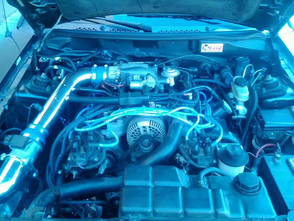

I know I'm late. But this is as hidden as it can get. I know WE all know what we're looking for but hopefully no one else does :rolleyes:. I'm going to be painting anything left over purple to black. Only because.....purple looks waaack.
I saw the nitrous nozzle. It's not very well hidden actually.
My 2.3 has a little 35 shot... I have friends who have been playing with cars for 40 years and it still took them at least 2 min to find the spray nozzle. If I didn't tell them it had nitrous, I bet they never would have found it. ;)
However, I have the advantage of more tubing to hide it in because of the front mount intercooler.
