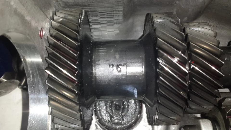

well, heres something that's NOT normal as far as i can tell.
went to look for a new input for it (pilot bearing surface is a bit too far gone for my tastes), and it has the standard 10-spline input and v8 pilot, but 28 teeth on the gear. looks like all that ever came in v8 mustangs was a 23-tooth (3.35 1st) and a 24-tooth (2.95 1st), so wtf is this thing out of? case is stamped as being a '92 model, and has the later 5th synchros and reverse spring/pin, but no neutral switch hole. bought it used years ago (as a "kit" with bell, flywheel, etc), and dont have the id tag.
Can you see the 3-digit number stamped on the countergear? If you get a flashlight, you might be able to see it wth the maingear still in the case.

I'll look at the cluster when i get home, already got the mainshaft out and apart, so should be easy to see. I know the input stamp ended in 51 though.
So i can only for sure tell 2 digits on the counter shaft, B6_ and im guessing the last digit is a 3, whoever stamped this thing did a piss-poor job of it. Pic attached.
I triple checked the input, it for sure has 28 teeth. Kinda hard to get a picture of though.

Thats all i saw on it, I've seen pics of the normal shafts that have a longer part # on them, but that's the only one on the one I have. I just picked up that tko Saturday anyway, but would be nice to know wtf this thing is so i can sell it and bs the next guy.
You may have a "Mutt T5". Just like the funny looking dog down the street with big paws and short little legs, it may have an unknown heritage...
Someone may have assembled a piece of this and a part of that and you are the recipient of their efforts...
