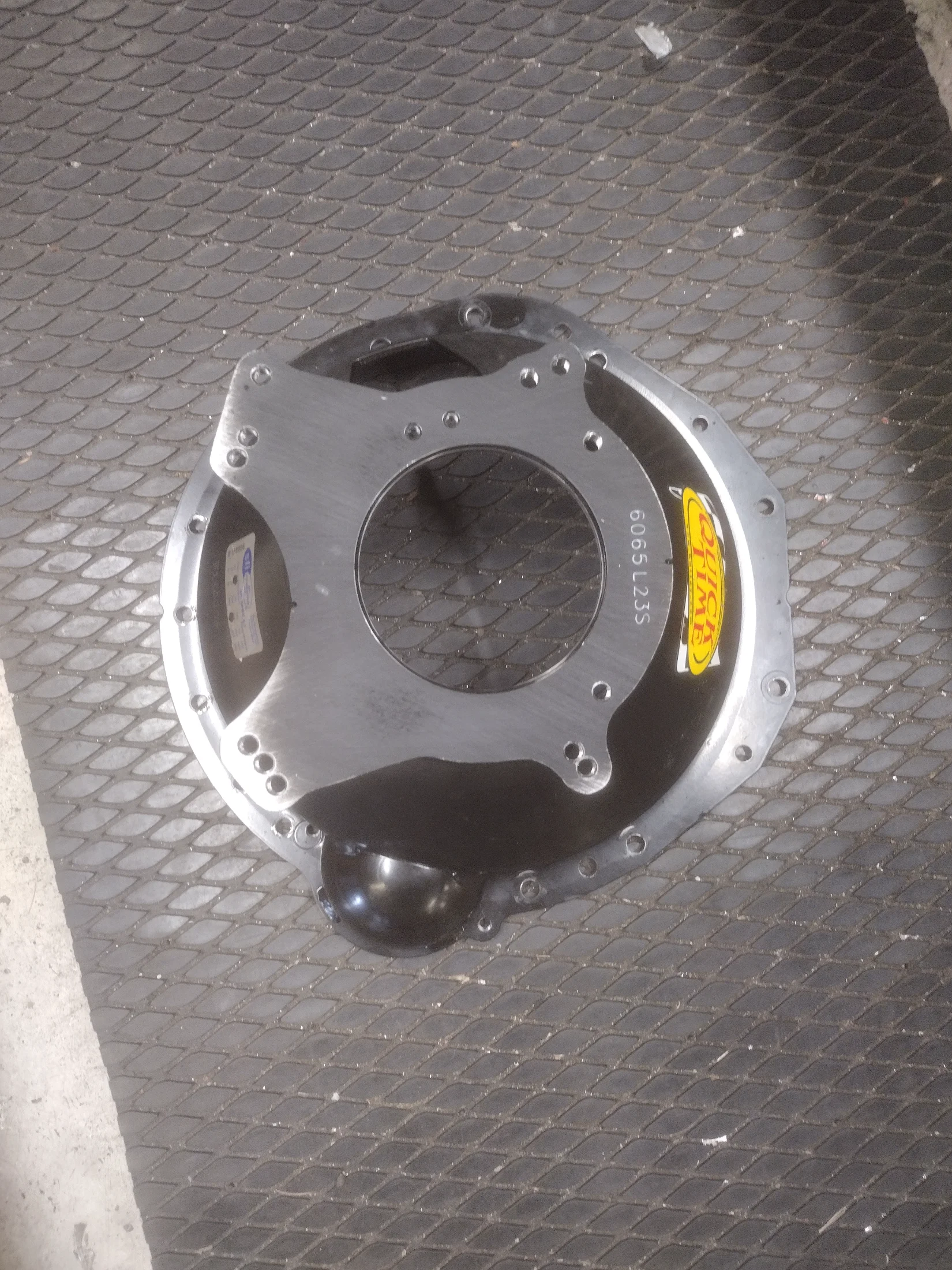

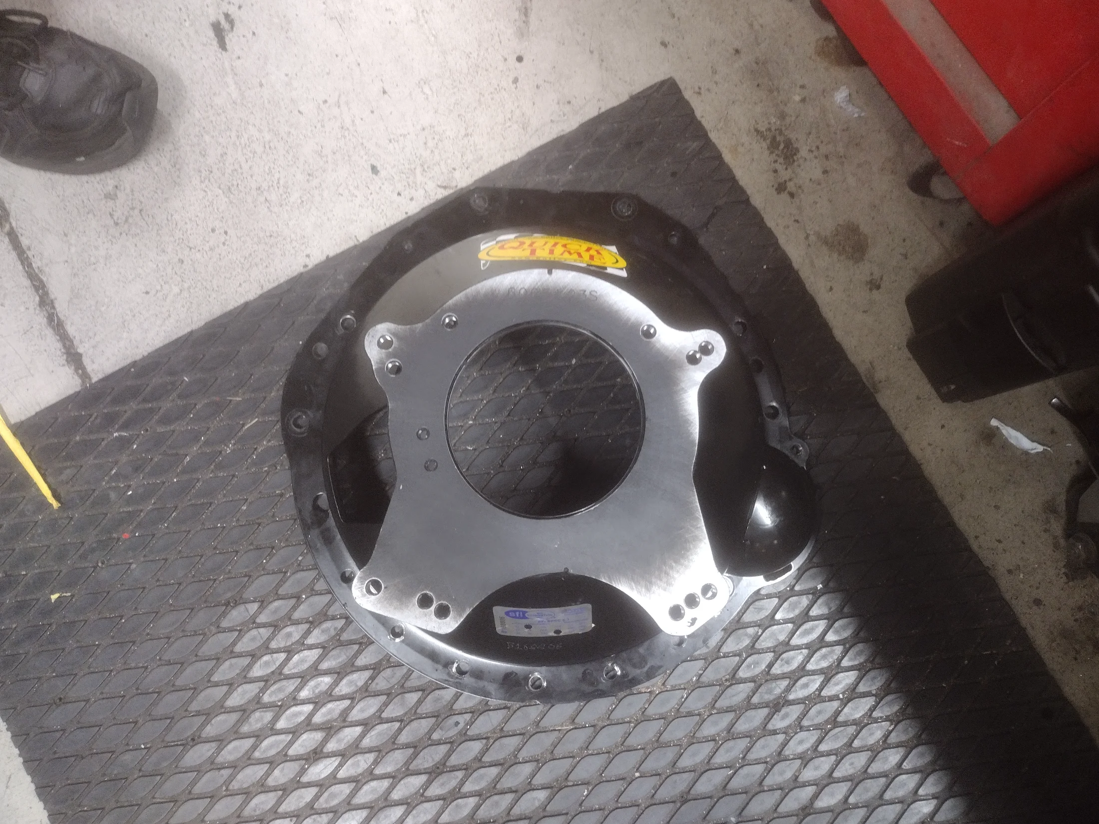

I'll discuss what I did below, but overall, it does shift better. Good, not great. If I were to get into this car at random to drive it around, I would say it shifted well, but I would expect it to be better knowing the transmission was new. It doesn't clank into gear as it used to, and it definitely shifts better. I feel better that Tremec took it apart and inspected it too.
What's new:
Fluid: I used GM Synchromesh 10-4006. The fluid seemed similar to ATF and may have helped. I read a lot about different fluids here and on other sites and this was recommended often.
Bellhousing: I looked at my input shaft tolerances to make sure I was parallel and centered. I ended up taking the bellhousing off to start from scratch to make sure it was shimmed correctly. While the bellhousing was off, I decided to put it on a glass table (granite is the way to go, but I don't have granite countertops) to see if it was flat. Glass is smooth, but not necessarily flat, but it was the best I had. The engine side of the bellhousing seemed fine, but the back had a warp to it. I brought it to a machine shop that was reluctant to machine the top because they didn't want to machine too much off and then the inner ring would be too shallow to accept the centering ring that adapts the Quicktime bellhousing to the TKX transmission. What he did do, however, was to put sandpaper on a large piece of granite and sand down the powder coat to see if there were any high spots, and there were. Pictures attached. The high spots were on the 'ears' of the bellhousing where the transmission bolts to the bellhousing. We started off with 80 grit to take off powder coat and some metal if needed. After we were done, we checked the best we could, and everything seemed to be within 0.0005. I still will jack up the rear and see if the wheels spin as suggested. Last night I was in a rush to get it out.
I re-shimmed the bellhousing to the motor and checked it to within 0.0015 parallel.
I spent a lot of time to get the bellhousing centered to the motor 0.002 concentric.
I made sure to fill it with the proper amount of fluid, and not too much. The transmission will hold more than the fluid capacity, which may be how my car sits, or how the transmission is designed.
I could tell a difference immediately and it shifts much better. Again, good but not great. Some shifts are better than others, even shifting from and to the same gear (ie: 3rd to 4th) isn't completely consistent, which still doesn't seem right to me, but I'm going to enjoy what I have.
