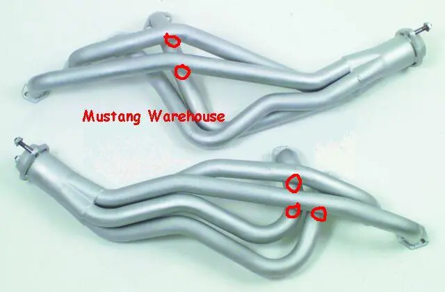

Do you guys who have 1 5/8 MAC long tube headers have tubes on headers tauching on a few places , I wanna know because I have some vibrations and I tryin find out from where that come from
Here is pics where tubes tauching each other
I've had these long tubes installed since 1998 and have had no noise/friction problems at those points. If you have at least one bolt in each tube, that should be enough to prevent individual tube movement. Perhaps the headers are rubbing on another part or the rear of your cat-back is mis-aligned?? Hope this helps... :flag:

All of my individual tubes don't touch each other or anything else on the car. HOWEVER, my prochamber midpipe didn't fit well to the headers. The midpipe was narrower than the headers and I had to 'bend in' the headers to get them to fit into the prochamber.
