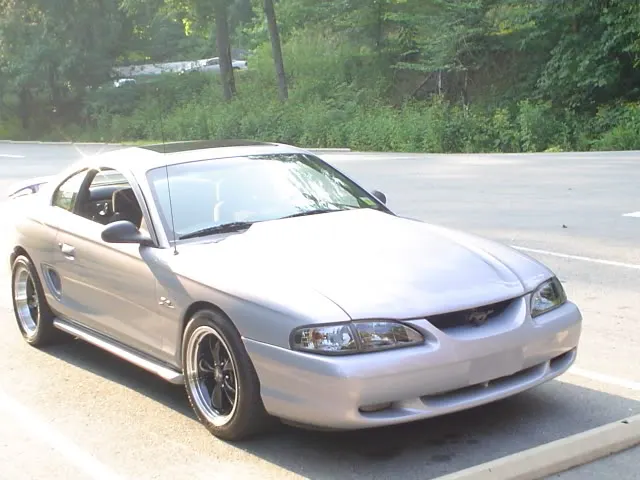

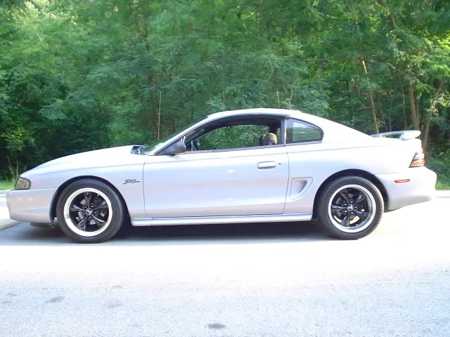

FYI: I realize NE Stangs are a little bit different than SN95's. Our cars look more like that have a "lift" from the factory, lol. This is just to show you that your choice in products are THE BEST.
H&R Super Sports
Maximum Motorsports Caster/Camber Plates
Tokico HP Struts & Shocks for Fox Body
(I chose these so they wont hyper-extend with the drop)
Ride is BETTER than stock .....
BTW, the back is usually a hair lower. I removed like 30+ lbs. from the rear of the car, plus I was almost out of gas.
