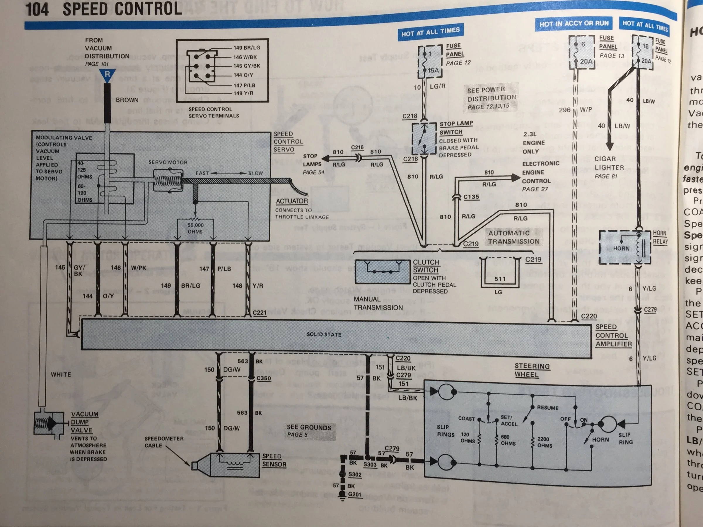

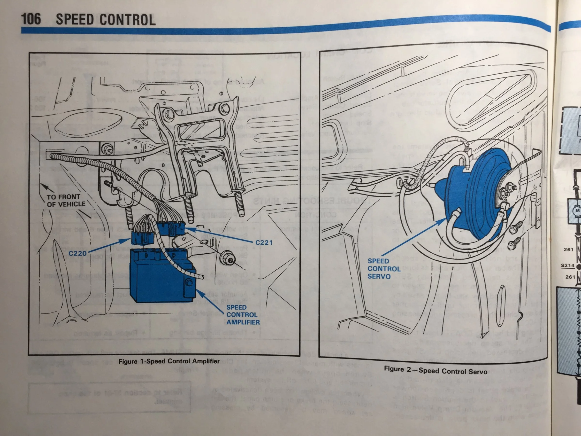

Dump the computer codes, look for codes 27 or 29. The following are diagrams courtesy of Tmoss & Stang&2birds
