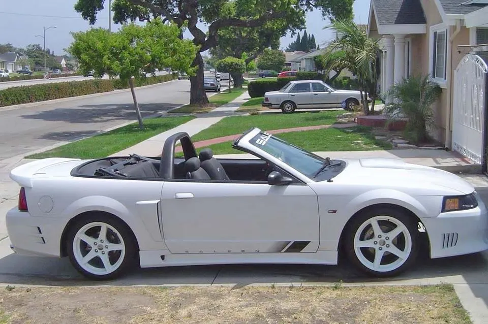

Here's a picture of when I first got them (just a few minutes after install):
I did change to Eibach Pro Kit since I was scraping almost everywhere.

Use the stock isolators to help make it lower. Never heard of Supersports having stance problems....only the sportlines from eibach. Can you post a pic of your car showing the stance? Definately isn't going to look as crazy low in the rear as the sportlines

I don't know about H&R Super Sports ever sitting higher than advertised.
When I first got them in, my car was freakin low as heck.
Vert springs! The verts drop MUCH more than the coupe springs (they even state it on their website!). I had exactly the same thing. Scraping everywhere, got Roush front springs - perfect now.
