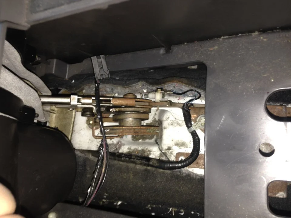

Hi, I'm not very knowledgeable when it comes to cars and I'll admit that first off. That said, I'm pretty good at looking at something on Youtube and doing it to my 2003 3.8 V6 Mustang if maintenance is needed. The car failed inspection due to the parking brake. Looking at this picture after removing the center console, am I crazy or is there no parking brake cable in the car at all?

The upper parking brake cable is integrated into the bottom of the handle itself. You will need to disconnect the cable f3om below and replace the handle. I had mone break once amd replaced it with the GT500 handle assembly
Thanks for the reply! So this means that I shouldn't have to see the cable wrapped at all then, it is just underneath the hand brake and I can't see it unless I go under the car? Is there a way for me to just tighten it so I can pass MA inspection (hold at 1200 RPM)?
