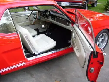

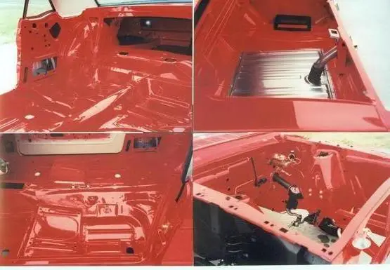

I have the Lokar hand brake and cable kit. Explorer rear disc. Used a Lokar billet trim ring and boot around the hand brake and T-5z.
On trans tunnel. Sorry these are the only pictures I have right now.
Before carpet. Old scanned pics.
