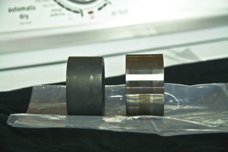

I decided after swapping EVERYTHING with all new pulleys, I called Kenne Bell and told them i might have squeaking Idler pulleys for the supercharger. After a little talk, we found out my Kit came with the Old style Idlers that are known to squeak after a while.

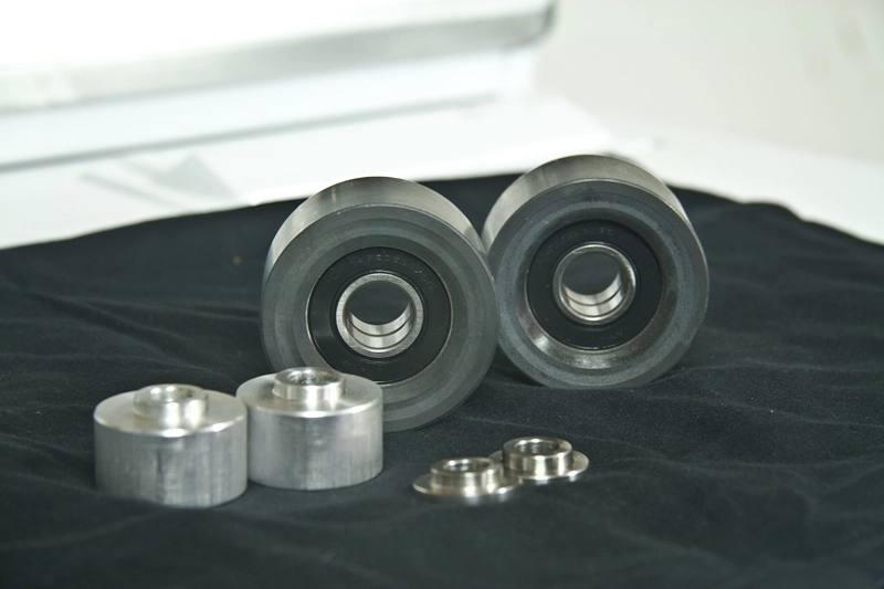

Kenne Bell told me they had new Updated pulley they could hook me up with. So, I took a drive down to Kenne Bell Headquarters and picked up the New Pulleys. The new ones are Double Bearing and and more heavy duty. The older pulley had failed and the bearing had started to leak the grease out causing squeak.
I have almost 2,000 miles on these idlers and they work Great so far!!! I really wanna try and get some METCO idlers if i can get some custom made just cause i know they look great.

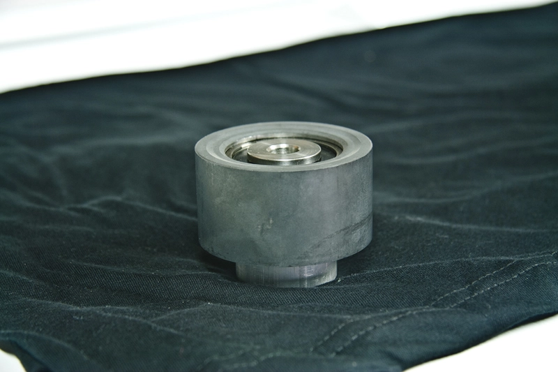

New Kenne Bell Idlers

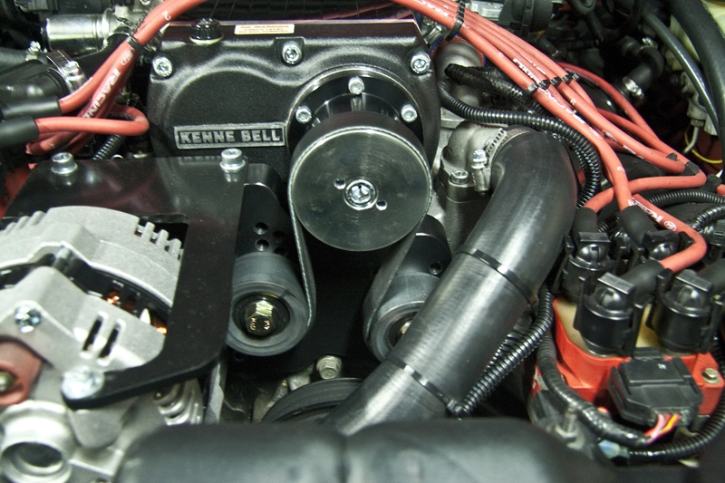

Idler Set up with the Custom KB Spacers

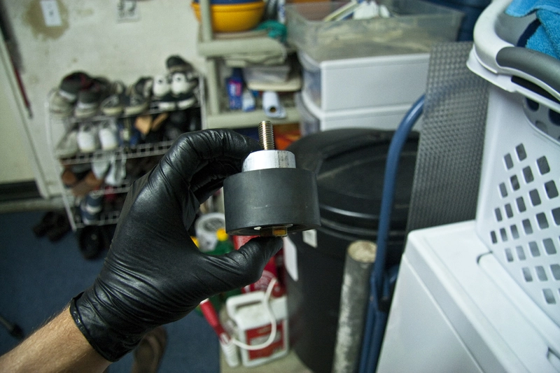

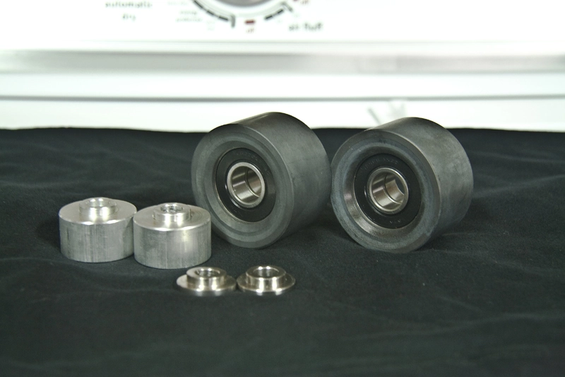

Left = Updated KB Idlers, Right = Old KB Idler

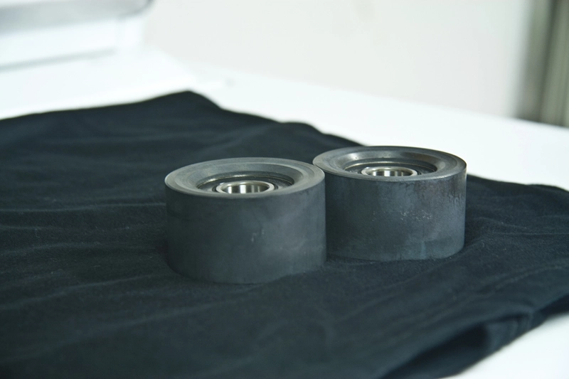

Old Idlers Removed

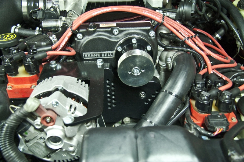

Installing New Idlers
