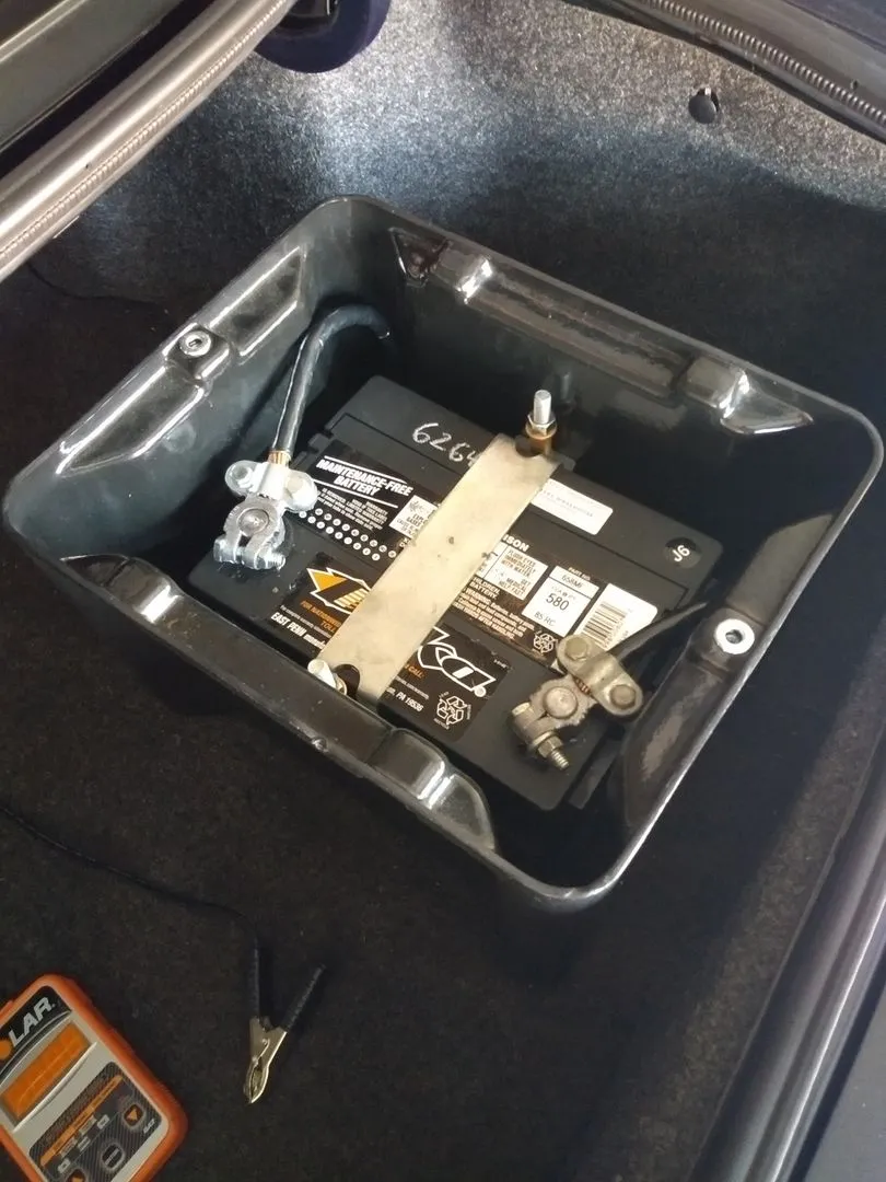

This is the battery. I tested it with this solar unit after the car sat overnight. This device said battery was weak. Then I started the car, ran it for a few minutes and checked again. Then it said it was good. Still having it checked out on Friday.
The battery cable is 1/0 gauge.
