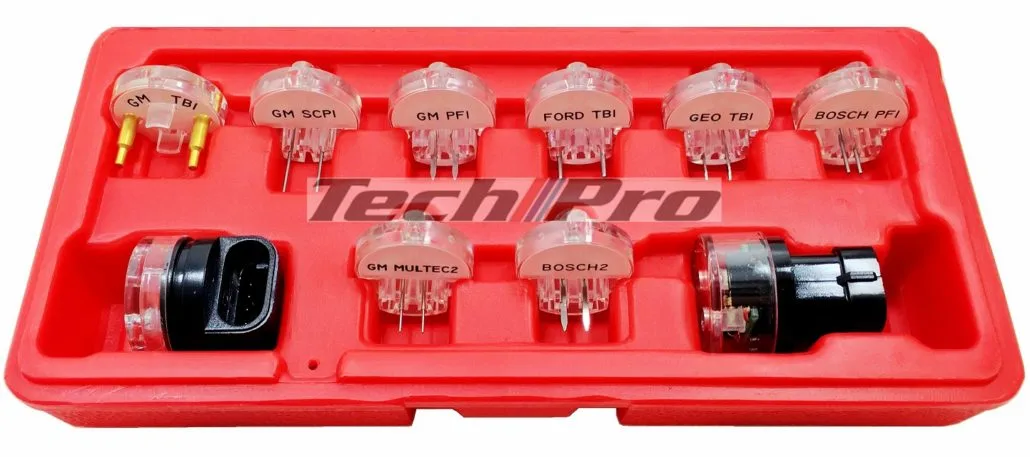

Get a noid light from AutoZone or other auto parts store, or even better a set of them.
This one is from http://www.summitracing.com/parts/oes-25142?seid=srese1&gclid=CMXk7M6dmM0CFdgOgQodGUMHWQ and costs about $6.
3.) Use the noid light to determine that the injector pulses and isn’t stuck in the on position.
If you have a set of them install all of them and compare the pulse intensity. Install the noid lights, turn the ignition switch to Run and crank the engine. A light that doesn’t pulse and stays on has a short to ground in the computer side of the circuit. That can be either a wiring fault or a failed computer. \
