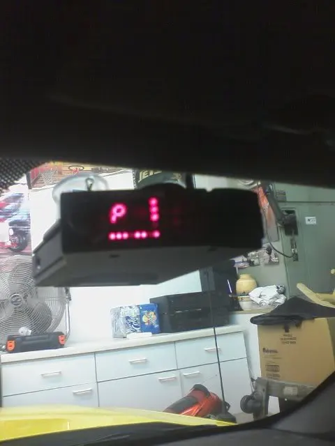

I recently purchased a valentine V1 and was going to hard wire it into the car so I don't have to use the cigarette adapter. My few questions:
1. How do I remove the overhead light fixture? I easily pulled back the paneling on the passenger side by removing the visor screws. I don't need it all very far back, but far enough so that I can access the wires. The light almost seems like it snaps out but I didn't want to break it.
2. Coming out of my auto dimming rear view mirror w/ compass, I have three wires, purple, black, and white. I need to know which one is the switched power on, because I have an inline wire tapper that I will need to wrap around it. I know when messing with the stereo the white was the switched power, but I just wanted to make sure before I went tapping into the wrong one.
I tried looking for manuals documenting what was what, but failed at locating what I needed.
Thanks in advance!

I realize this isn't really what you were asking for, but I thought I'd mention this as another way to go. I ran the power cable up underneath the head liner where it meets the windshield and then down the passenger side A-pillar to the fuse box. The power cable supplied with the V1 is long enough to make the run.

I just went to the front. I attached the ground, which is easy, and then with the other wire I just slipped it in with the fuse that was already there. They make these little taps you can solder onto the wire then just lip in with the fuse. Like these: Fuse Taps (4-Pack) - RadioShack.com

I tapped fuse location 12, bottom center. If you can't make the taps you have work you can try using bare wire. Just make sure you get a good connection.

I just got it in there. I used fuse 12 like you said, I wrapped the wire down in front of the prong. Should stay in there. Thanks for all the help!
