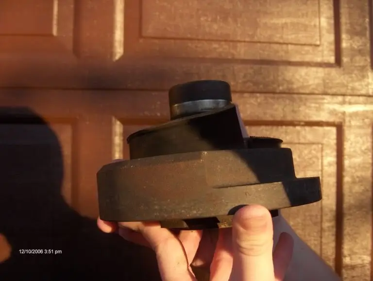

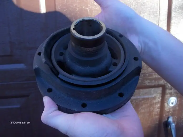

You are looking for not this:
If your balancer looks like this... its bad...

those pics are extreem cases too. when mine went i first noticed the timing was waaaay off. it said 30* and was supposed to be 12*. then i noticed a slight wobble on the crank pulley which is bolted to the HB. Once i got it off i noticed how it was warped. Soooo with that being said if you timing is way off and your crank pulley has a wobble then a new HB is in the near future for you

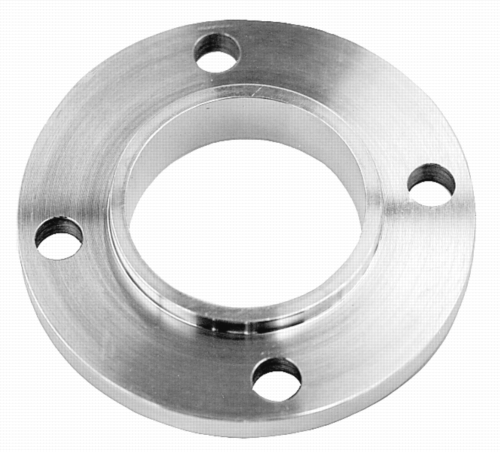

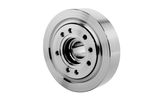

Anyone here using ford racing SFI balancer? It's this one
<table class="catalogtable" cellpadding="2" cellspacing="0"><tbody><tr><td class="tddata-l" valign="top">M-6316-A50**</td><td class="tddata-l" valign="top">302 (1981-93)</td><td class="tddata-l" valign="top">50 oz.-in. <sup>1</sup></td><td class="tddata-l" valign="top">Meets SFI 18-1 <sup>5</sup></td><td class="tddata-c" valign="top">12.1 <sup>6</sup></td></tr></tbody></table>
<sup>1</sup> Damper has removable weight that allows use as a neutral balance unit for internally balanced crankshafts. 1994-01 Mustang and Explorer requires modification.
<table class="catalogtable" cellpadding="2" cellspacing="0"><tbody><tr><td class="tddata-l" valign="top">M-8510-B351</td><td class="tddata-l" valign="top">302
351W</td><td class="tddata-c" valign="top">1980 & later</td><td class="tddata-c" valign="top">4</td><td class="tddata-c" valign="top">0.950"
0.950"</td></tr></tbody></table>
I just bought one with spacer. It says it needs modification/trimmed. Anyone has experience with this balancer? Where and what needs to be trimmed and modified?
Thanks
This is a harmonic balancer that has had cured rubber inserted between the hub and ring (not hot bonded). As rubber is elastic it wants to spring back after you insert it. Usually the manufacturer takes this into account during the manufacturing process so it seldom springs back to this extent.
99FiveOh
May 20, 2006
2,051
20
99
J-Ville, FL
Jun 22, 2009
#19
  • Jun 22, 2009
  • #19
Seldom on other cars maybe, but commonplace for our cars. And the problem is the rubber comes out the rear, so it's hard to see while installed on the motor.
And I saw alot of discussion above about your crank pulley wobbling, that's not the case. The crank pulley is bolted to the center secion of the balancer with does not move, so if your pulley is wobbling you have another problem.
