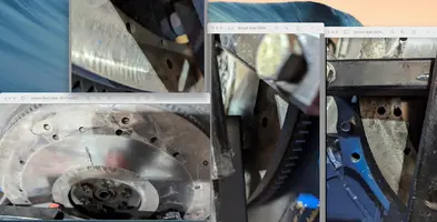

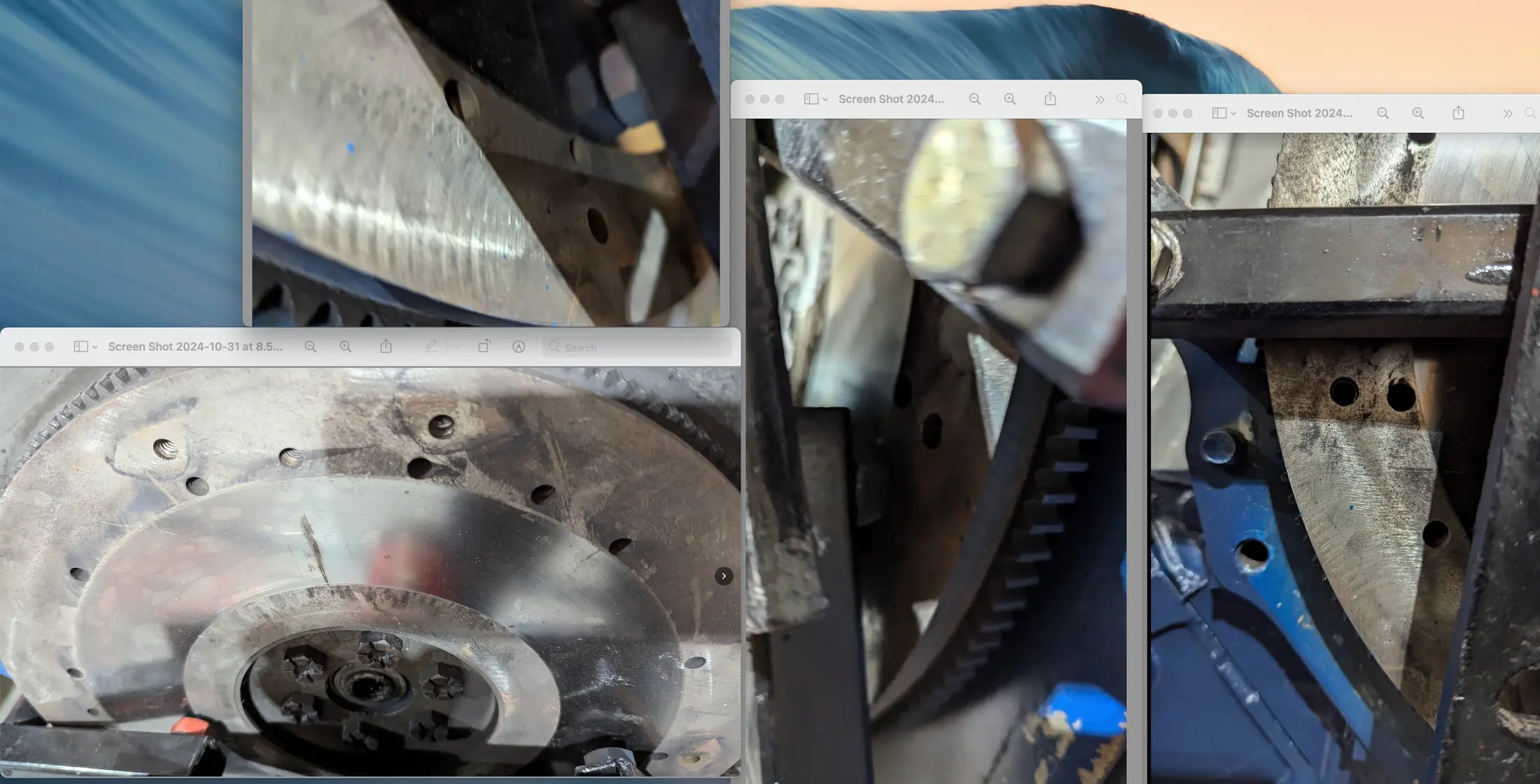

Transmission: have a Top Loader 4 speed.
Balance information:
The flywheel doesn't have any counter balance holes drilled into it. (see image)

  • I have a OEM D1ZE-6316-AB harmonic Balancer is excellent condition. 10.1lbs My current build utilized this particular balancer until I removed it to reseal /replace gaskets on everything. The only wear is the leader inner edge where clearly pliers have bent a little steel (see images). It looks like some minor cracks at 2:00 on image
    • This balancer is OLD it has sat un-spinning for 20 years. I'm worried about the rubber and its general health.

Here are images of the old HB the engine was built with (it has 3 holes drilled) I assume those holes are for balance?
