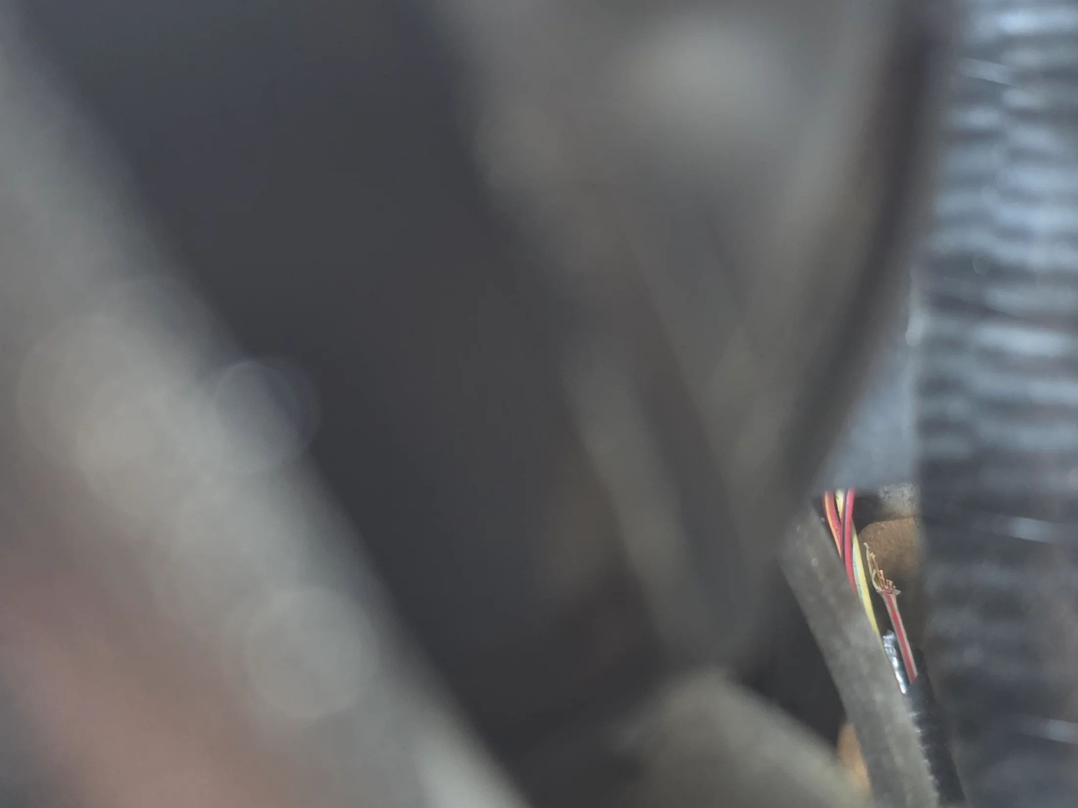

UPDATE
Bank 2 Sensor 1 wiring:
Red/Yellow (heater power, Pin 69) → Good.
Red/Blue (heater control, Pin 29) → Good.
Yellow/Blue (signal return/ground, Pin 70) → Good.
Gray/Red (signal, Pin 10) → Came back as open with no continuity. So I tested with all 70 pins at the pcm connector and still no continuity. This is also the same wire that would read 0v during testing when it should have read .45v
Seeing as the Grey/Red wire is the issue I began looking further into the wiring loom, and behold, I finally see the cut wire. I keep looking further to find the other half and there it is, melted to the top of the transmission.
Now the only issue, is how will I repair this? There is very very little room back there. I feel like at this point, I have to have a shop replace that wire.

UPDATE
What I would do if it is a pain in the ass to get to is run a [new] wire then cut and bypass the old wire altogether.
Solder the wires and wrap with dielectric grease and shrink-tube.
Just find yourself two convenient points in the wire to cut and splice. Make sure the new wire is secure when you're done.
