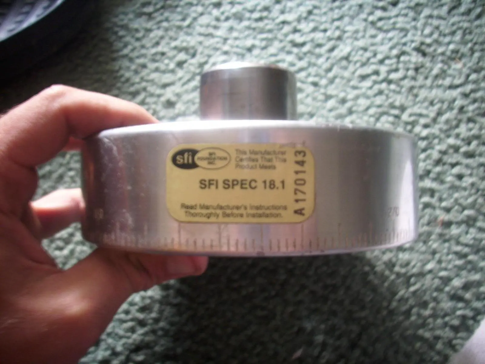

purpl_stang said:
A170143 Thats the one i got thats on the balance that im lookin at right now
Take a picture of the back of it (side with the snout).
purpl_stang
Aug 1, 2009
Buchanan County,VA
Aug 31, 2009
#11
  • Aug 31, 2009
  • #11

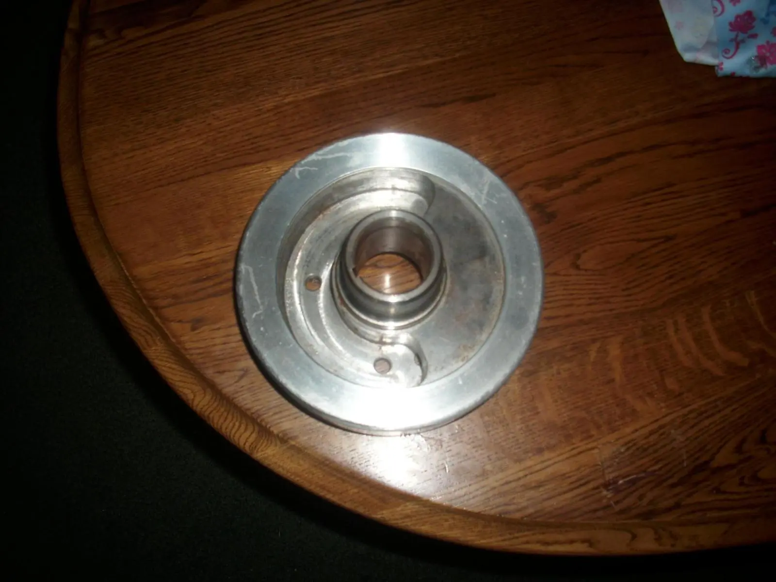

See i this will help ya and if itdoes can you tell me how you from lookin at it.
57fairlane
Apr 2, 2005
560
Oakwood, GA
Aug 31, 2009
#12
  • Aug 31, 2009
  • #12
hmmm . . . I would say its a 50oz. Typically the 50oz weights are almost half the circumference while the 28oz weights are like 1/4 to a 1/5

It's impossible to tell from those pics. That number is just a serial number.
You should call Summit with that serial number and they should be able to tell you what it is. It usually takes about 5 minutes. It is better to be safe than sorry.

BTW, that opened space in the back is where the bolt in weight goes. My 50 oz Summit SFI balancer (Summit SUM-C4270 - Summit® Bracket Racer SFI Harmonic Dampers - Overview - SummitRacing.com) has that weight in place and it's supposed to be there with a 50 oz imbalance. I would absolutely call Summit and see what you have and what you're doing.
