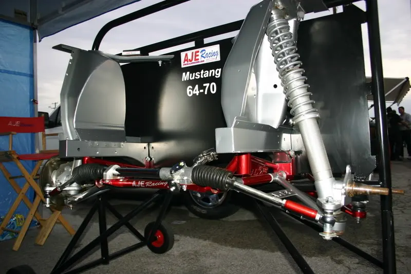

Has anyone checked out AJE's new front end?

I was wondering if anyone had checked into this? It seems to have alot of benefits to the performance crowd.

Hrm... Mcpherson strut. A lot of great handling cars have them. I was never greatly fond of it because as the suspension compresses the wheel doesn't stay level with the ground. Don't get me wrong... Saleen for example seems to be pulling over 1g with them on the last gen Mustang so I can't argue with the results. Very interesting I am interested to see how they perform.
Kevin
Hrm... Mcpherson strut. A lot of great handling cars have them. I was never greatly fond of it because as the suspension compresses the tire doesn't stay level with the ground. Don't get me wrong... Saleen for example seems to be pulling over 1g with them on the last gen Mustang so I can't argue with the results. I just think double A arm is just the way to go.
Kevin
BIG improvement over stock!
I want one for that reason and it looks to be a lot easier to install without cutting into the car. Plus I hope it's more affordable than a MII conversion.
Like most of us, money is what prevents most of us from doing what we really want to do versus what we can afford. :bang:
Yeah, but it does come with your choice of motor mounts. You can run a SBC, BBC, SBF, BBF, MOD 4.6, or LS1...
And the install is simple. You cut out the lower control arm mounts, notch the towers, locate it off of the belly bar mount, drill 4 holes, and you are done!
You can also run Heim Joints or Polys.

I talked to them, and it takes alot of weight off of the front. Somewhere between 90-110lbs off of the front end, depending on if you had factory disc or factory drums...

I saw that one too. It appears that it keeps the upper control arm. Is that correct?
I guess when you break it down to the pure engineering, you're right.
But when you are looking at application specific, there cannot be a reason on a drag car, or even a steet/strip car, to add so much weight on the front if you have the choice. And when you are looking at an early Mustang suspension, the benefits of a strut style front end far outweigh the drawbacks compared to ole' faithful. Heck, when you look at the success of the fox body on the drag stip, its obvious that it works well.
Now Road Race may be, just may be, a different story. lol :nice:
Man, I did some more research, and this thing is even better than I thought.
If any of ya'll want to take some serious weight off of your street/strip or drag front end, I would highly recommend it. Mine is in the mail. I will keep ya'll posted.
