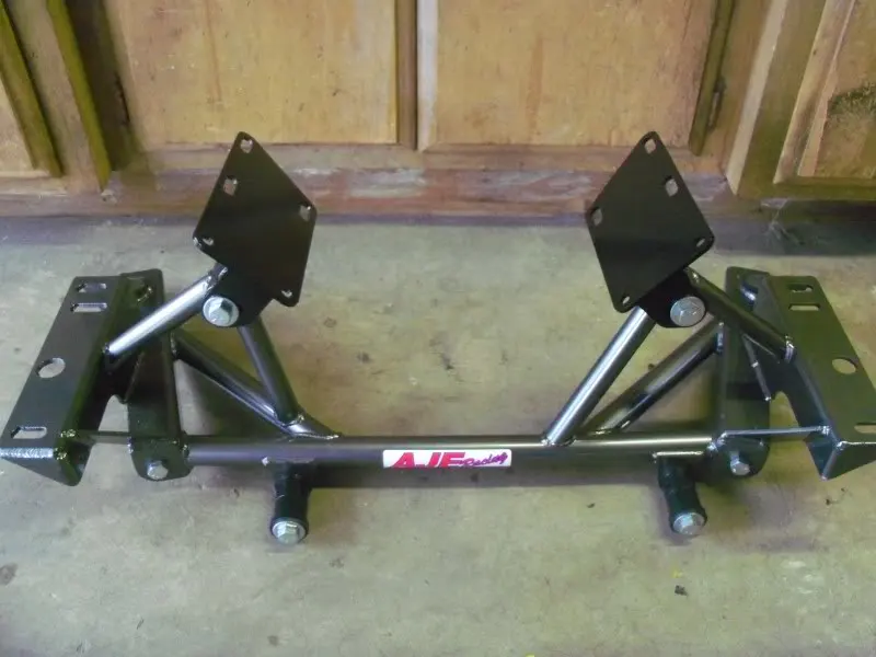

Has anyone checked out AJE's new front end?

anyone besides me think they messed up on the downtube from the motor mount on the passenger side
Answered your other post, but that's how mine was also. No worries.
Can you snap a picture of the portion of the strut where it mounts to the ball joint? Is it steel or aluminum on yours. Mine was aluminum the first time and that crap just about got me killed at the drags. They swapped it out with steel for the mounting point but geezus that was a stupid design.
