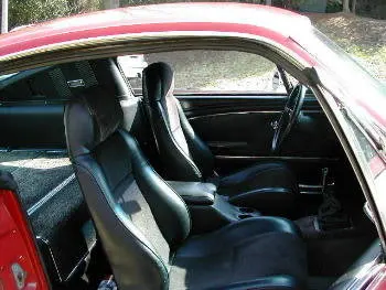

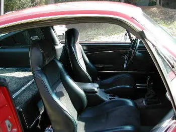

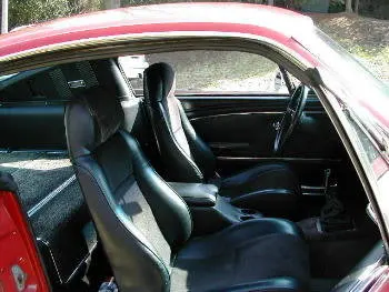

That was me that posted about the Fiero seats several years ago. I pulled a pair from a junk yard and had them reupholstered with a cloth insert down the middle and vinyl to match the interior on the sides and back.
I never hooked up the speakers, so I can't comment on them, but the seats were very comfortable. They, also, maintain the seat height, unlike some of the aftermarket seats (that raise the seat position and squeeze you toward the steering wheel). I just mounted my old seat tracks to them and installed them identical to the stock seats.
Tim

Tim, thanks for chiming in I knew someone here did but couldn't remember who. So no regrets I take it then, that's good to know. They look great in your car! The cloth inserts look better than I thought to. I was pondering an alternative to cloth that would hopefully stay cooler with the top down in the sun the same way. I may have to try some test swatches like that now. I can't believe that you never hooked up the speakers though, to me that was the biggest reason I have been seeking a set of these. Of course you do have a hard top so less incentive I guess. That's good to know about the seat height, that was my second reason for wanting a set. I wasn't sure if because they were so low that they needed the old seat tracks attached like most replacement seats do or not. Any drilling involved or did they pretty much bolt right up? I'd love to see any/all pics you have of them like the above one if you want to email them to me.
