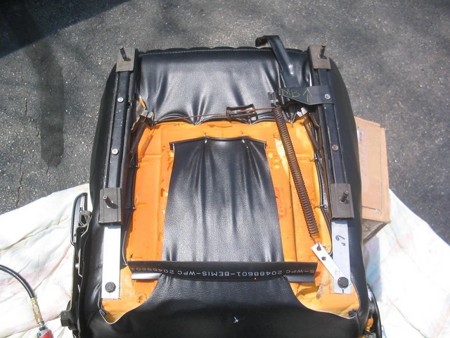

I just landed a pair of '84 Fiero seats today on Craigslist for -- I still can't believe it -- FIFTY dollars... I drove 1.5 hours each way though. Anyway, they have both recline handles, both mechanism covers and even the tracks (which I won't use). The driver's bolster foam is ripped a good 8" or so but all there so it can be fixed easily enough. I have some swatches coming from Mr. Mike (as a modified car I may go with leather in 2 tone front and rear).
I agree there's NO WAY a stock Mustang seat track will bolt properly to the bottom of the Fiero seats as they are -- unless you create an intermediate bracket to go between the seat and the stock Mustang tracks. I will use some metal stock 2" wide and weld together a square, then bolt it to the seat. The bolts holding the square to the seat may interfere with the stock tracks so that's why I made it 2" wide. So I can offset the track 1/2"or so if needed. Then I bolt or maybe weld the tracks to the new bracket. (Before I start that I need to check the Corbeau brackets I had bought to see if I can more easily modify them to fit, but they are at the paintshop with my car. They go for $150 so if they work that would be a big time saver.) Anyway, not the simple slam dunk I was expecting, but very promising nonetheless.

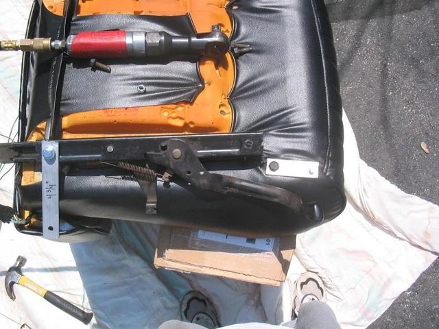

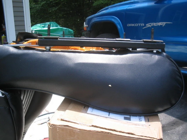

Here's the route I chose to take. I could have gone fancier and crafted some Z shaped brackets but in the end I was more concerned with it being solid, safe and affordable and with $10 in hardware it's all 3. About the only thing I would do differently if I did it again is cut the brackets at 5 3/4" and 3 1/4" instead of an even 6" and 3". This would have given me the same amount of meat on each sides of the holes front and back. Let me know if any questions. I look forward to seeing how you tackle it. I could have easily spent $30 and made look cooler but it wouldn't be any more secure and who the heck is ever going to see it.

I'm not sure how the different Mustang years compare but that was pretty much my plan also in the begining. Because the center line width of the Fiero track and the 69 track is only 1/2" I was going to ream the two front mounting holes into oval holes and then remove the rear brackets and just make new ones. After several days of dileberation and photshopping and measuring I decided not to for several reasons and it wasn't that much more work really.
A) even though the width is close the Fiero tracks are over 4" longer so the track would hang over the end of the floors seat pan and I didn't like this idea very much. B) you can gain 1 to 2 inches of extra thigh room to the steering wheel with the stock mounts. C) using the Fiero track means the bolts to the floor would be loose instead of fixed (unless you weld them too) and it is much easier to fasten the fixed bolt of the stock track from underneath.

Pakrat you are right the seat track does overhang the seat mount some but I really liked the position of the seat so I figured I could deal with it. The funny thing is I actually gained leg room for the people in the rear seat because the seat is fairly thin. I have the seats in the car at present I will take some pictures when I pull the seats out to clean and paint the brackets. What did you think of mrmikes covers, they look sweet in the picture do they fit tight like the original covers? I am not sure what I am going to do to recover my seats but those look like a quality cover.
