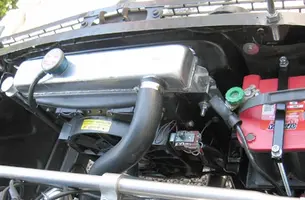

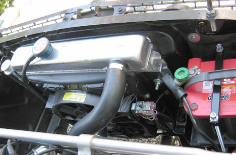

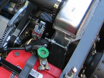

Hot Rod air has just the one setup for 65-66. I use it and it works fine. However, you will have to fab your own brackets to mount the fan to the radiator support. The brackets you see in the photo DO NOT accomplish that. They used to supply the brackets, but, for some reason, no longer do so. I fab'd brackets and used bolts per the attached.
