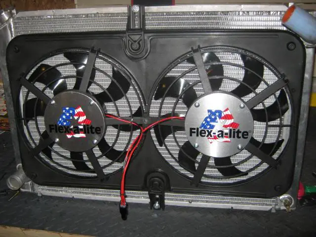

For the price, you may want to consider ordering a NEW Contour fan. This will avoid the junk yard aspect, and still get you an awesome fan. They can be bought brand new for half as much and only require a 40amp fuse.

Yea there is a lot of info around, I personally think the taurus fan is the better way to go for a cheap conservative build. The contour fans usually get expensive because most JY's will charge you for 2 fans, making it double the price of the taurus fan. Also, the contour fans are a little more difficult/expensive to control unless you plan on just turning them both on full blast when the engine reaches 175*(or any certain temp). Not really efficient.

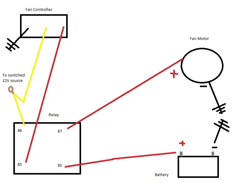

This is the one I used for my taurus fan. Thanks to Mustang5L5 for giving me the link and helping me wire it up. You basically have to use this controller to activate an 85 amp relay. The probe threads into the water outlet, at the top where most have a plug. You can use this for a contour fan setup but you will need to wire up two relays, and you will basically have them both come on full blast at a certain temperature, seems like over kill to me.

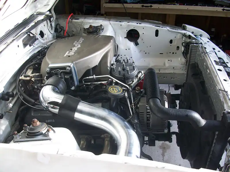

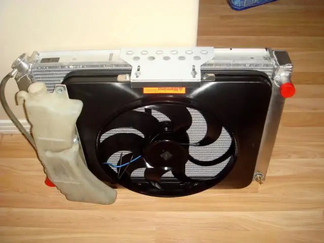

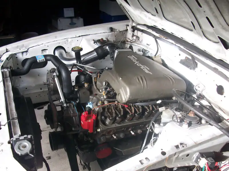

I dont have great pics of it but heres what I got. I will see if I can get some updated pics but I used the stock overflow tank. It forms perfectly to the taurus fan and I just used two screw to hold it on. I mounted the controller and relay in the fender. Also posting a wiring diagram I made for wiring up the controller to activate the 85 amp relay. And a link to the instructions for the controller itself.
Instructions: http://static.summitracing.com/global/images/instructions/der-16749.pdf
