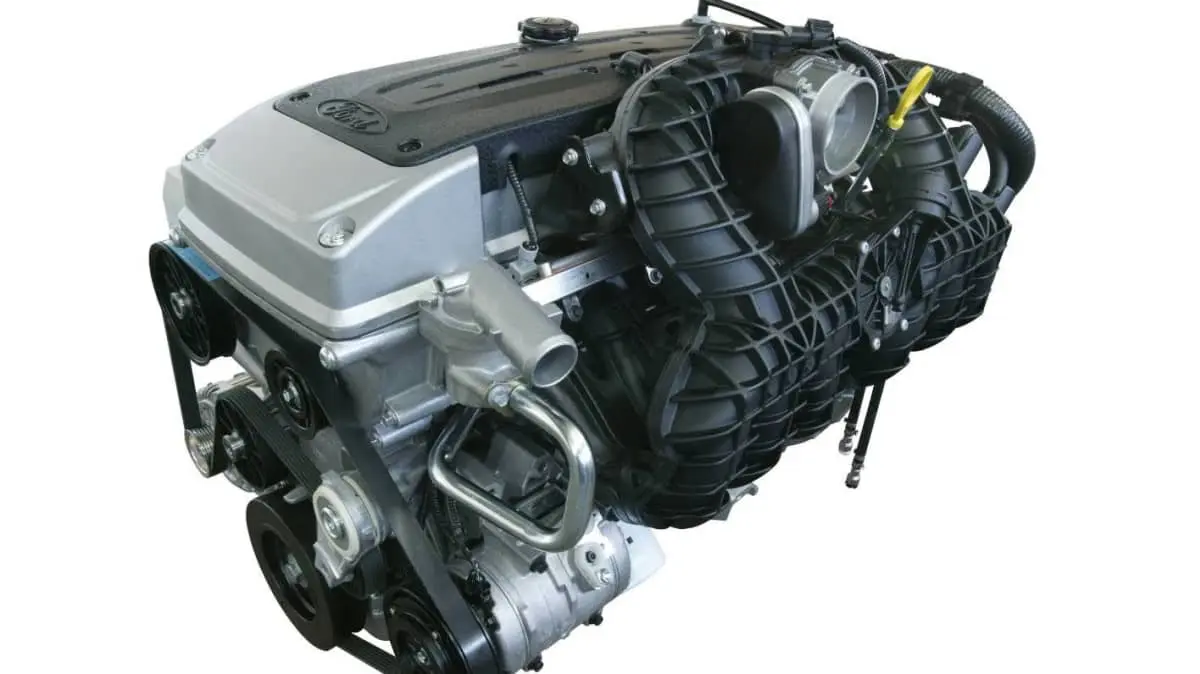

Your link doesn't load...but if you are talking about the BA engine(whether NA or turbo) its definately the latest and greatest in the evolution of the Ford I6:
However...it is not all aluminum, its a cast iron block with an aluminum head. You can get a non-turbo one for about $1600 or so from Ebay:

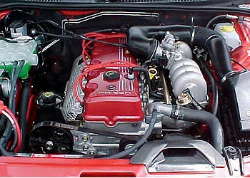

Sure...$1000 of that is shipping, but really not a bad price. I actually like the Intech version better though from an aesthetic viewpoint...less power, SOHC earlier version of the engine:
Unlike the Barra(above) the Intech still has a distributor...which means you can convert it to say triple Weber carbs. Wont make as much power but will look period correct.

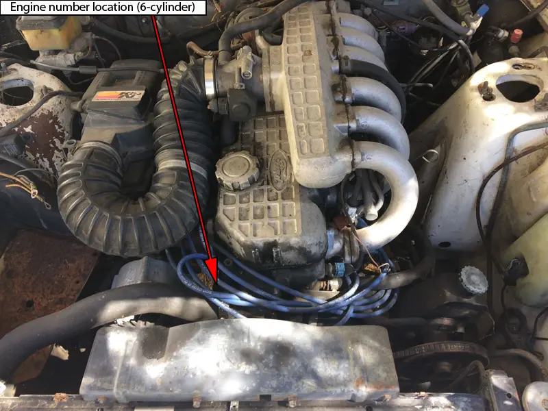

I was talking about one of these.

Early 90s was the EB engine for Ford Australia(either 3.9L or 4.0L), prior to the EB was the Aluminum 4.1L crossflow head(which is what your picture is I suspect). Crossflow heads have a clipped passenger side of the valve cover:
The crossflow head was aluminum(later ones anyway, early ones were iron), but the block was iron all the way through every iteration of the I6. However, the crossflow head is the only one that can be adapted(with modifications) to the US block...after the XE generation the block evolved away from the earlier design.
