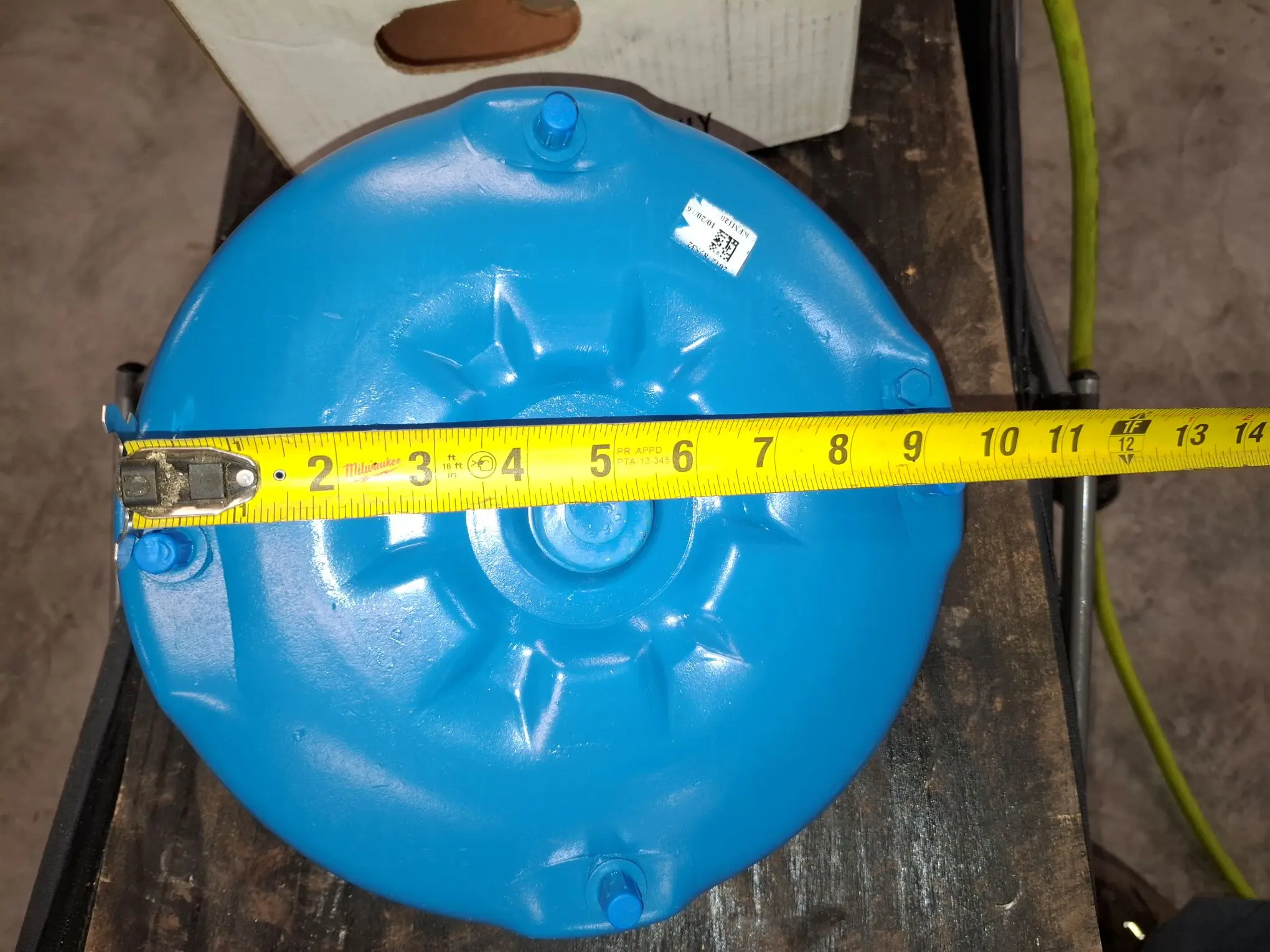

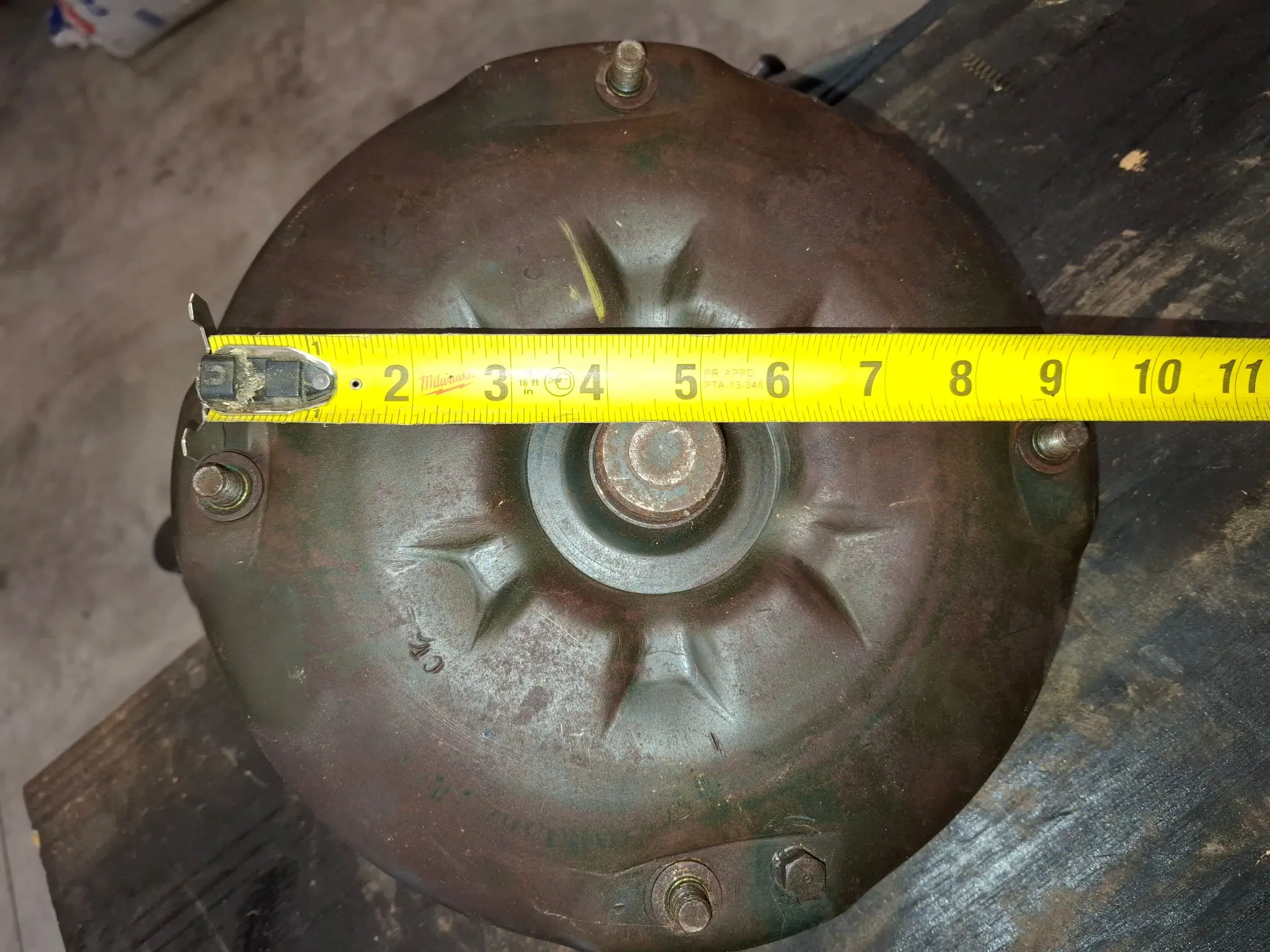

I remember seeing somewhere about the bolt circle being smaller than a standard Ford. It seems like standard Ford converters have a 10-1/2 bolt cirlce whereas the II has a 9-7/8 or 9-3/4 bolt circle. I'll have to search again and see if I can find it - seems like it would be pretty useful, especially right now.
The official dimension is 9.3 in. bolt circle, which seems to match my tape measure.
