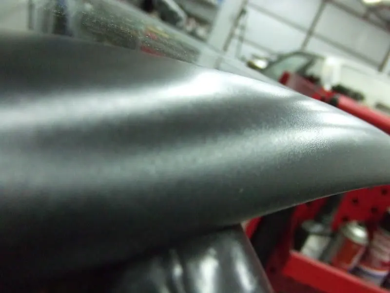

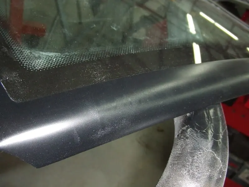

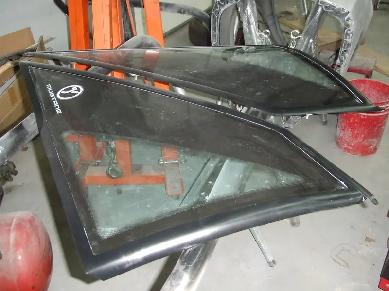

I repaired mine during my repaint project. get a high build primer and lay it on THICK, sand it smooth, spray some more, sand, then if they still need more spray and sand again, otherwise lay some black trim paint on them and call it a day. I'll post pics later, I'm on my phone right now
