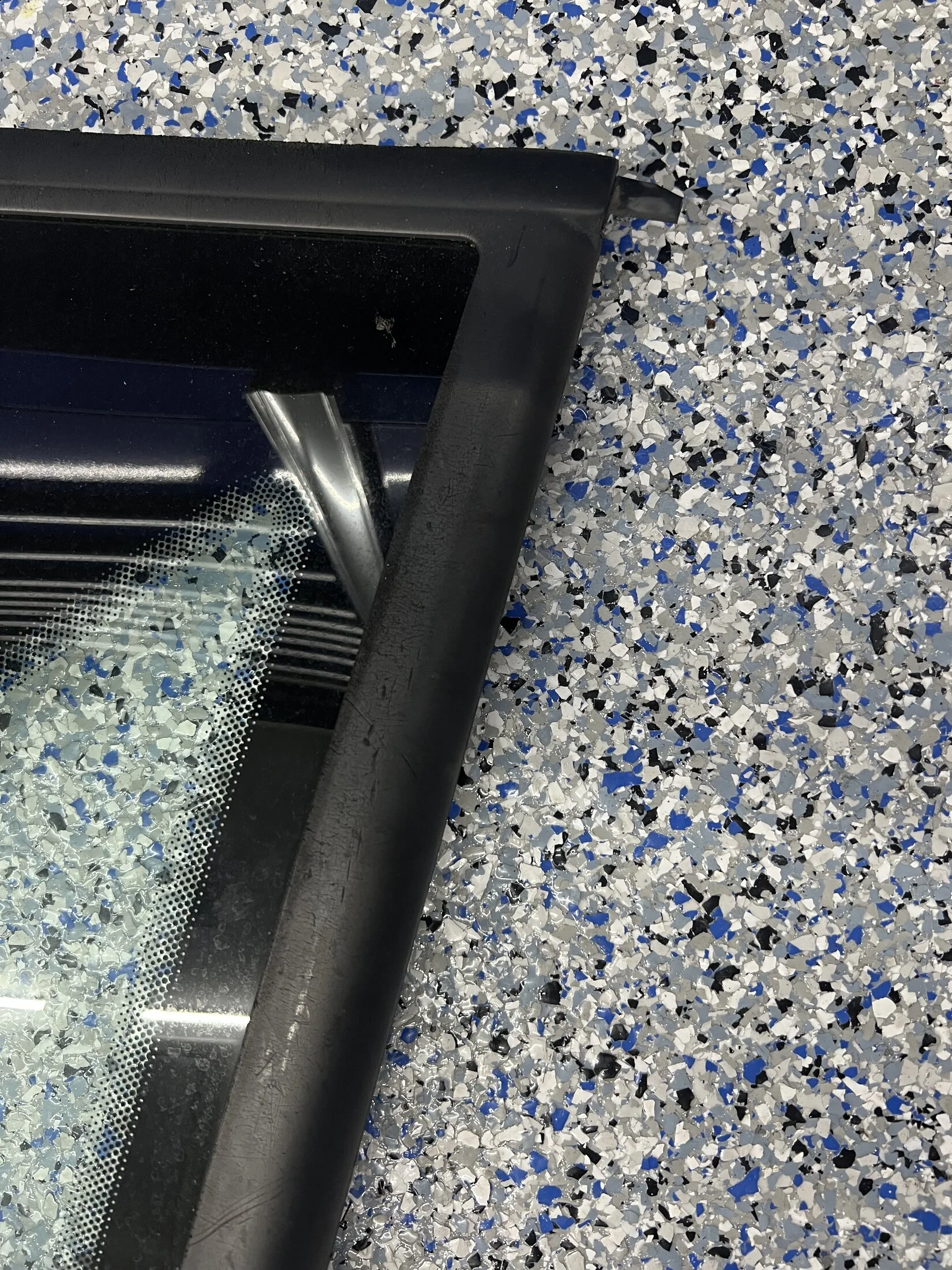

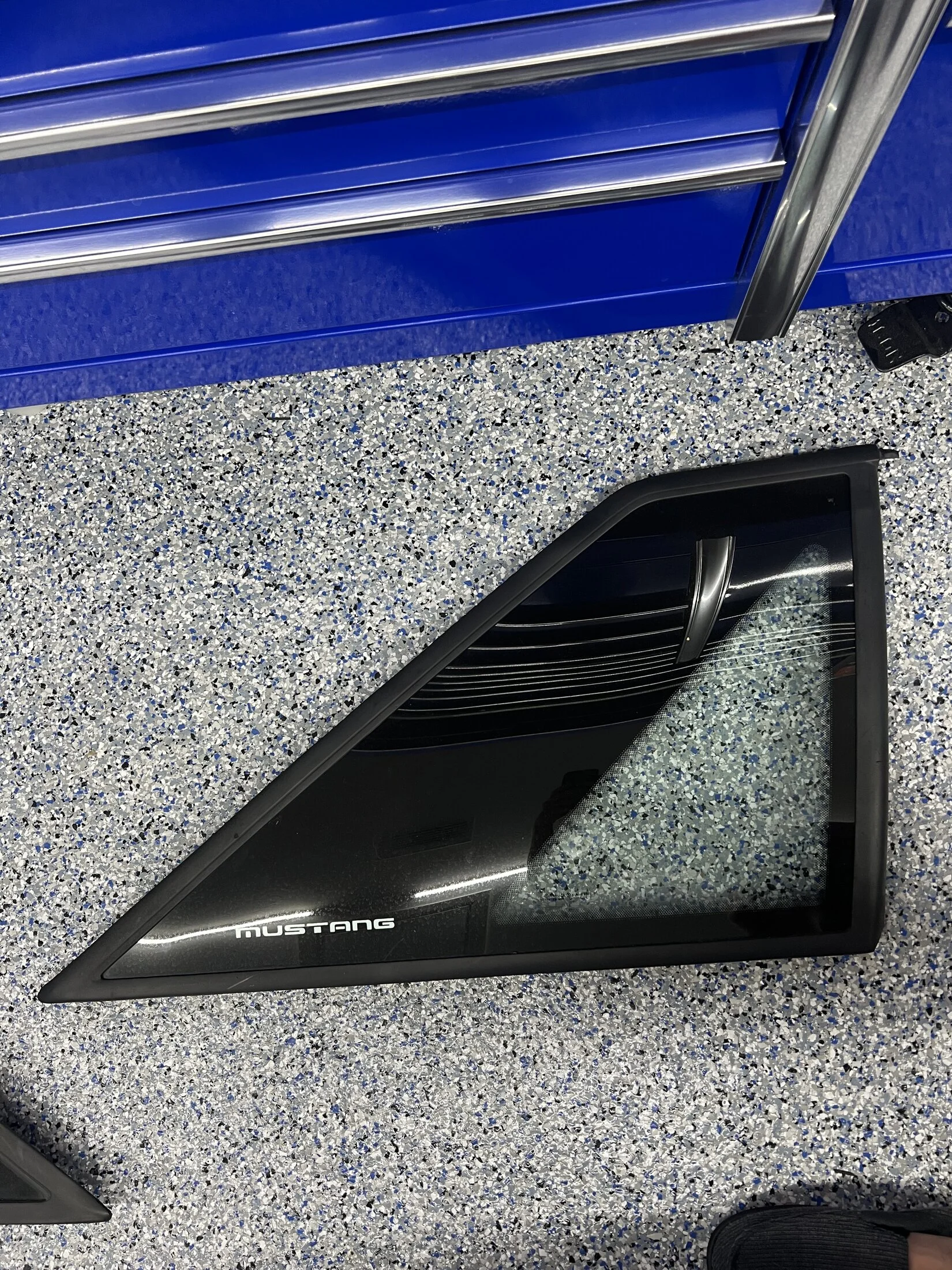

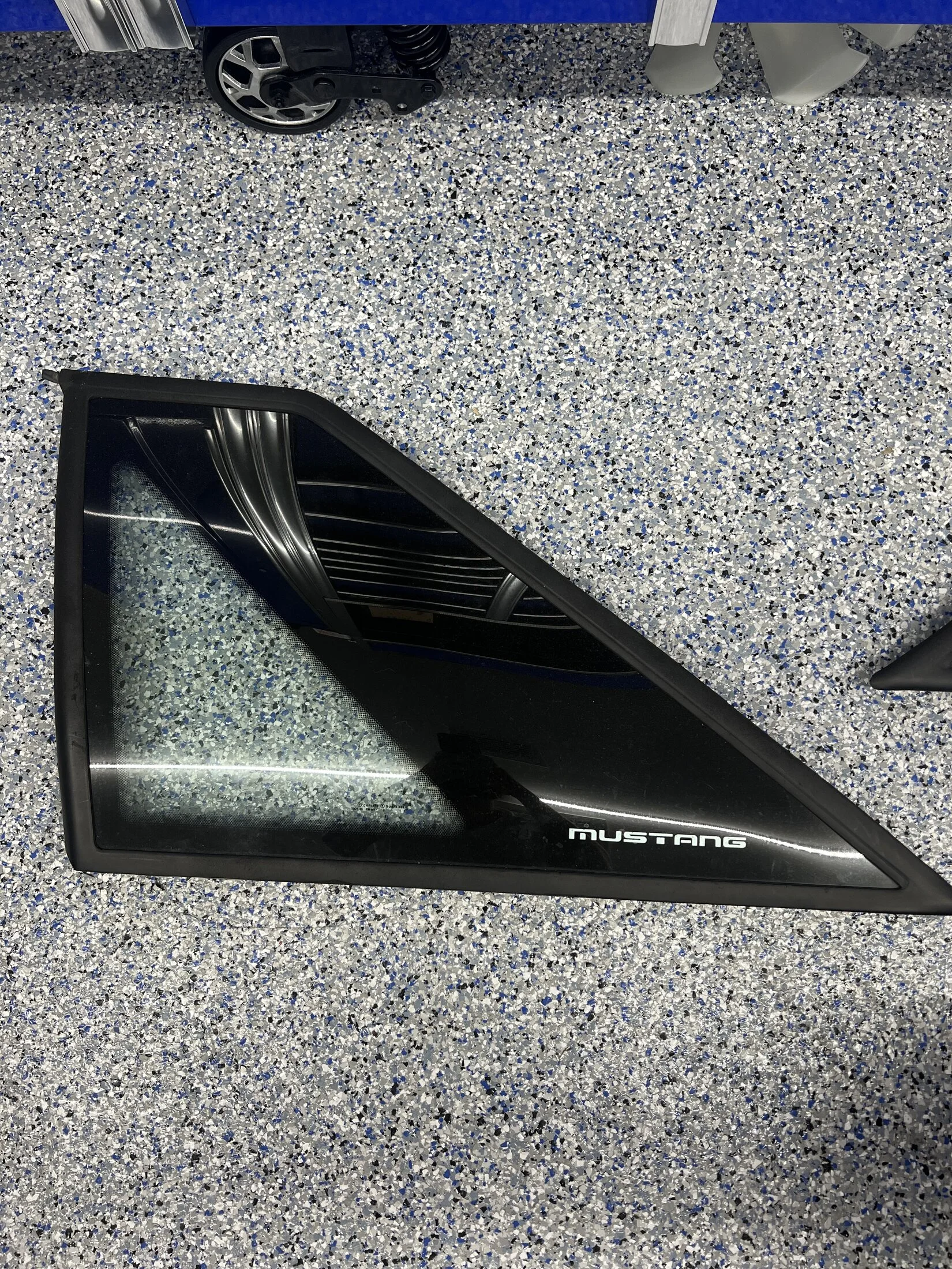

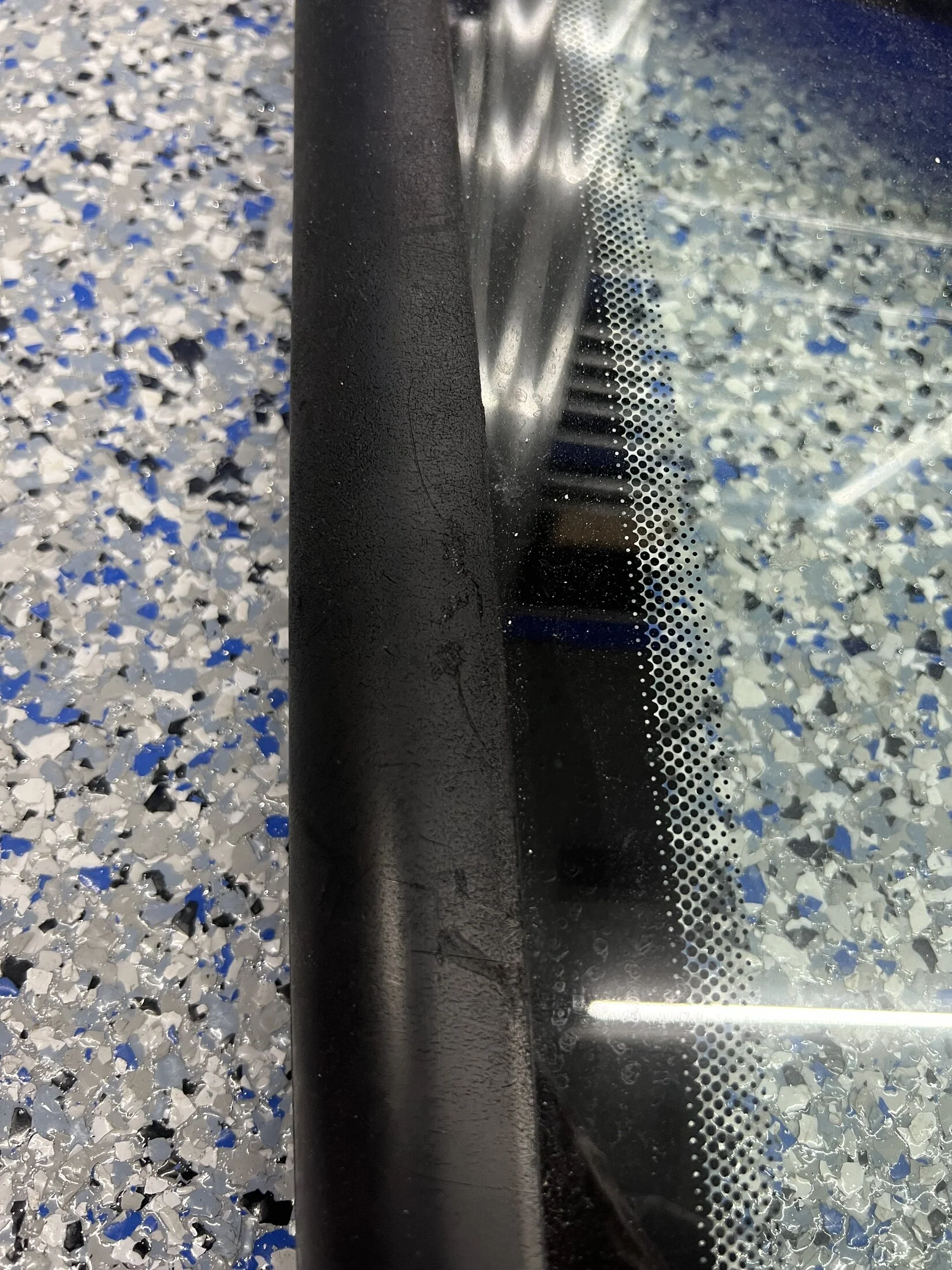

My paint/body guy is finally picking up my fox tomorrow. I’m debating whether I should ask him about doing some type of restoration on the quarter windows, or if I should just tell him to spray some paint on them and call it a day. As you can see in the pics below they’re in really good condition, especially for the fact that they sat in the Florida heat outside for 7 years with the previous owner. Pretty much no pitting and just some patches of wear. In my mind I’m thinking I should just get a fresh coat of trim black on them and live with whatever signs of aging they have, instead of gambling with restoring them and potentially changing the look and feel of the stock windows. Let me know what you guys think i should do.

Personally, I would sand them down a little and then build them back up with some primer to fill in those cracks, then trim black sanding between each coat to make them look new. Since my car is also at paint I had to do that with my windows but they were a bit worse than yours. Since you can see the cracks/pitting in yours if you're getting a nice paint job (not Maaco presumably) I'd do those right.

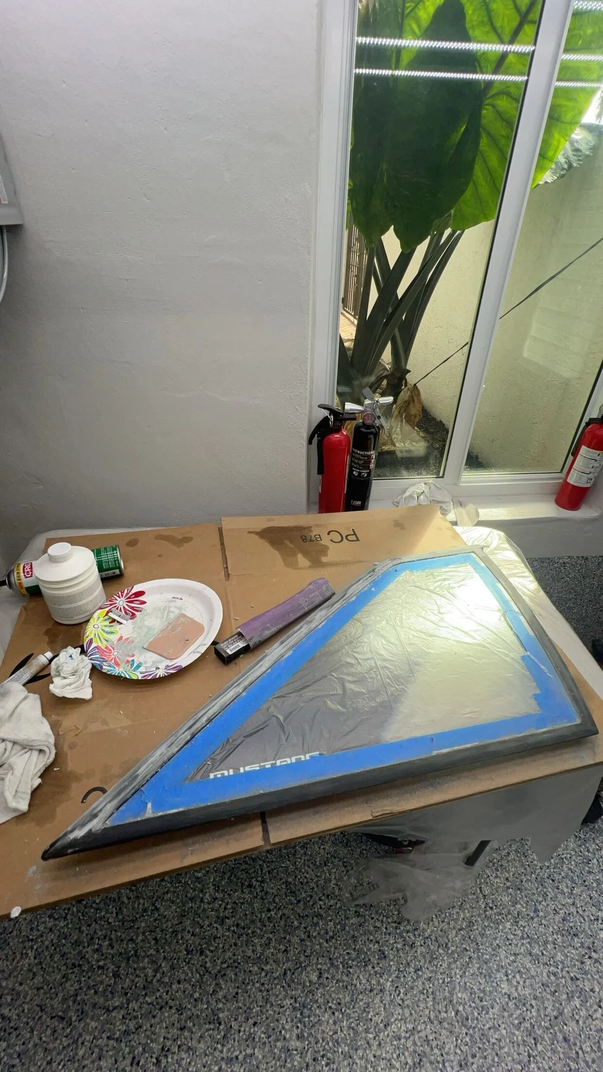

I’m no paint and body guy either that’s my worry but I went ahead and ordered the poly flex and some flexible high build primer and I’m going to try and do it myself over the winter break since I’ll have some spare time. Should be a fun project. I’m gonna follow these instructions by infamous project I bought all the same stuff he uses. Wish me luck haha.

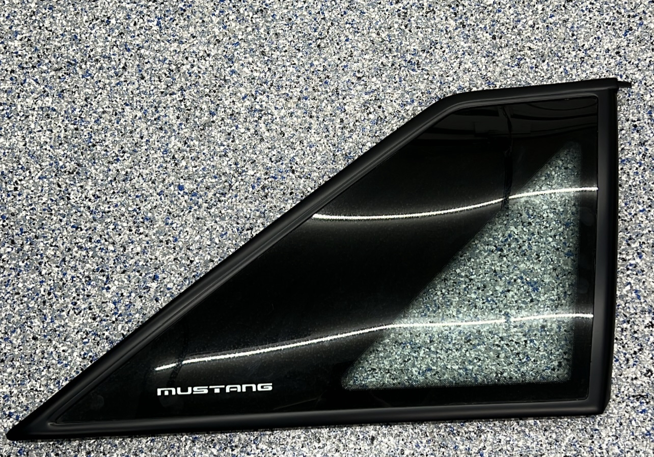

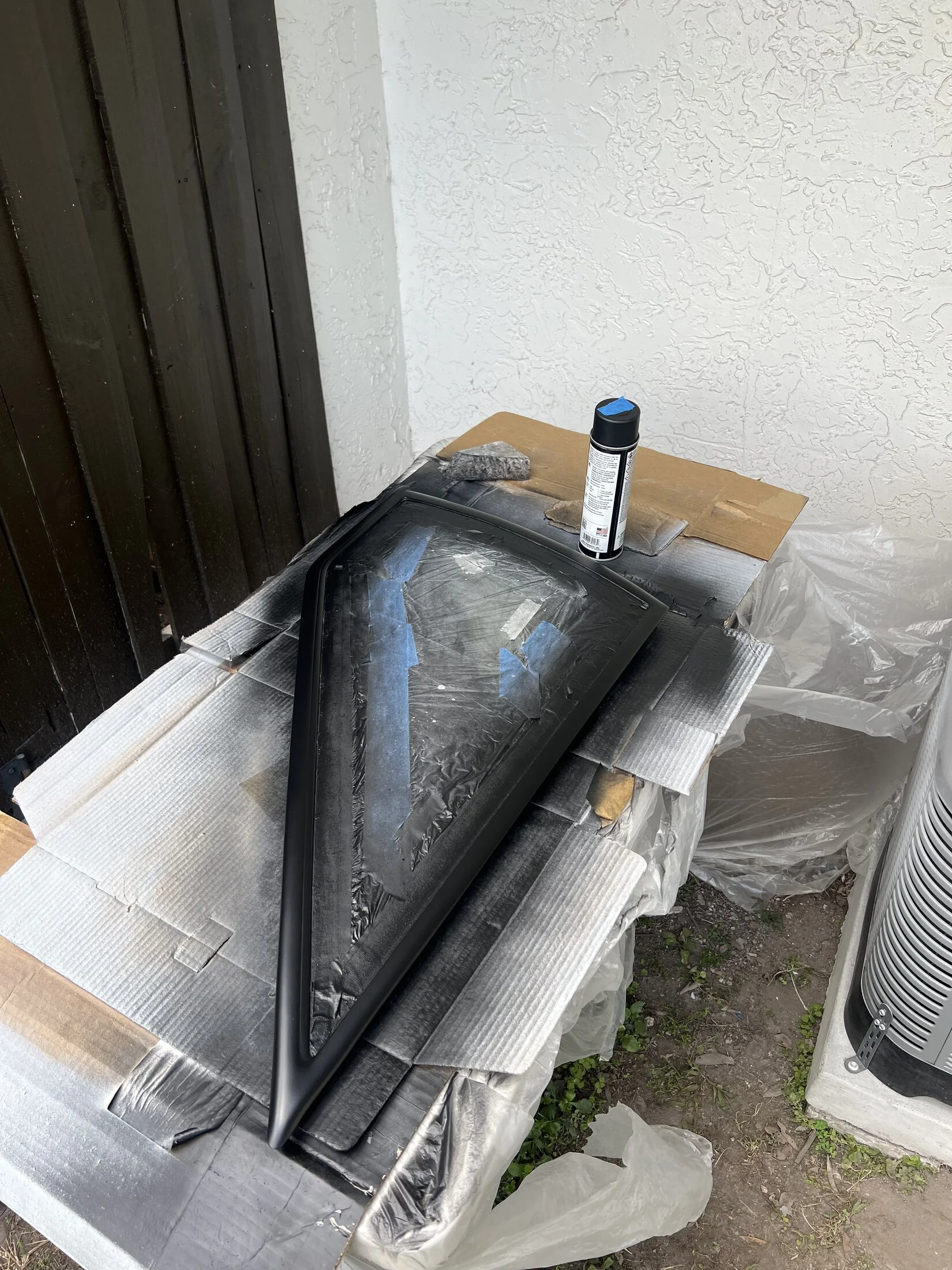

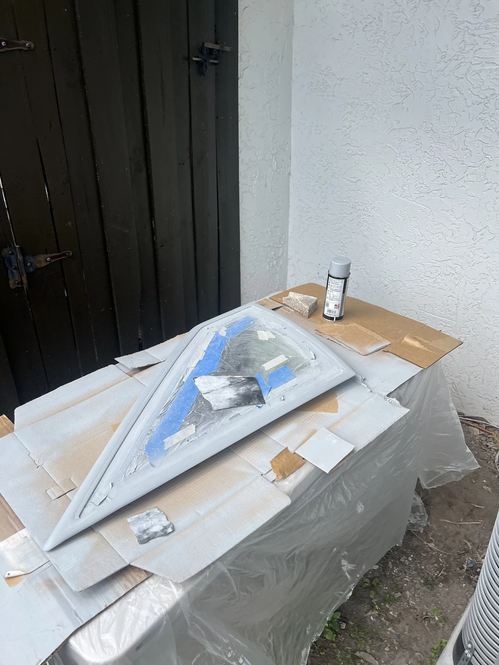

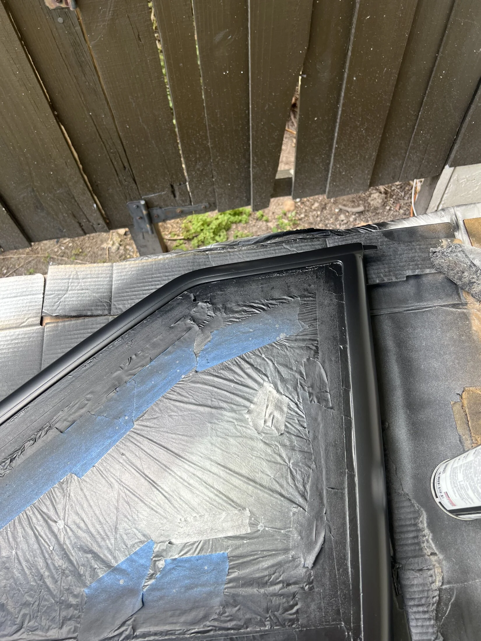

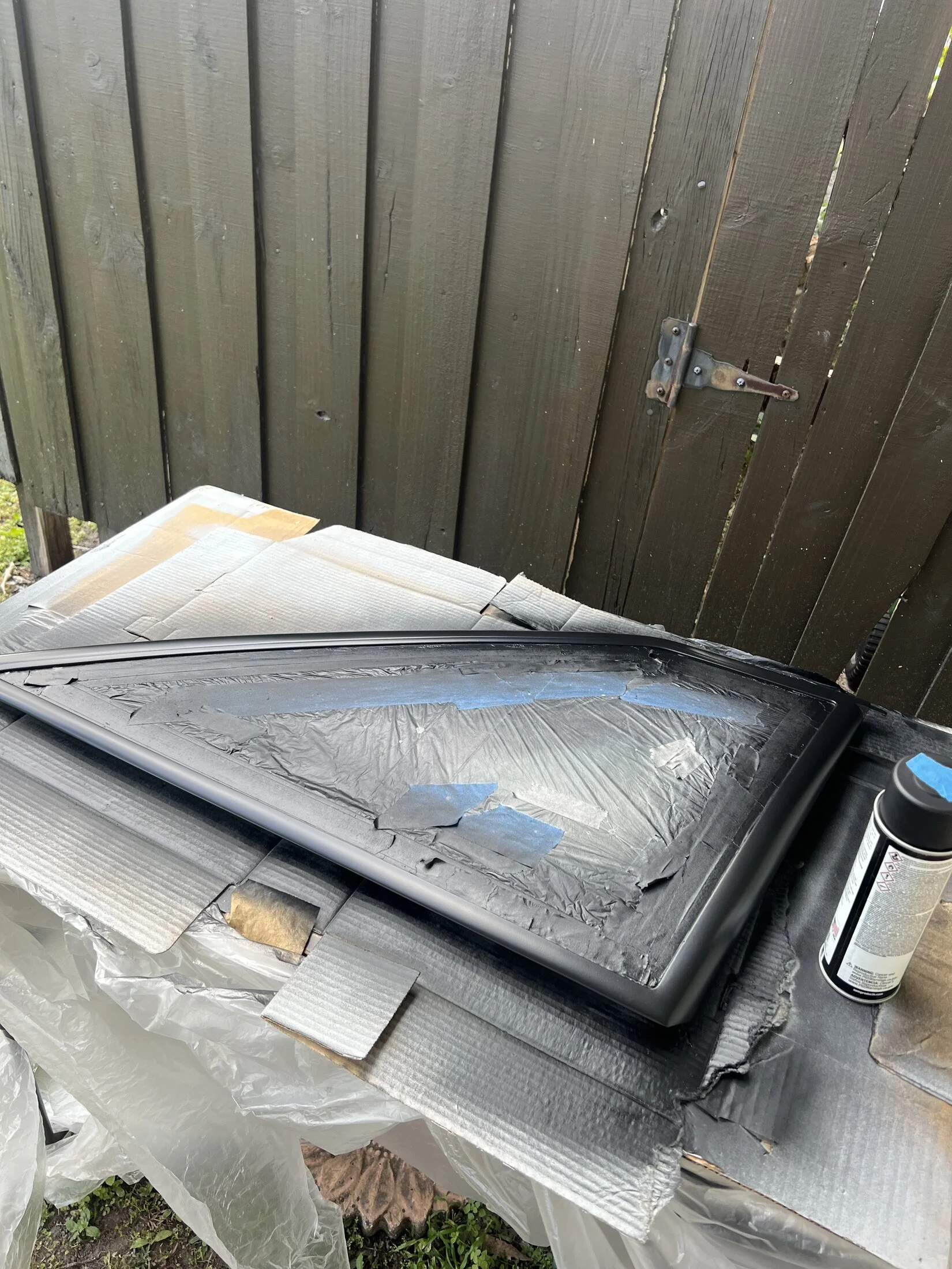

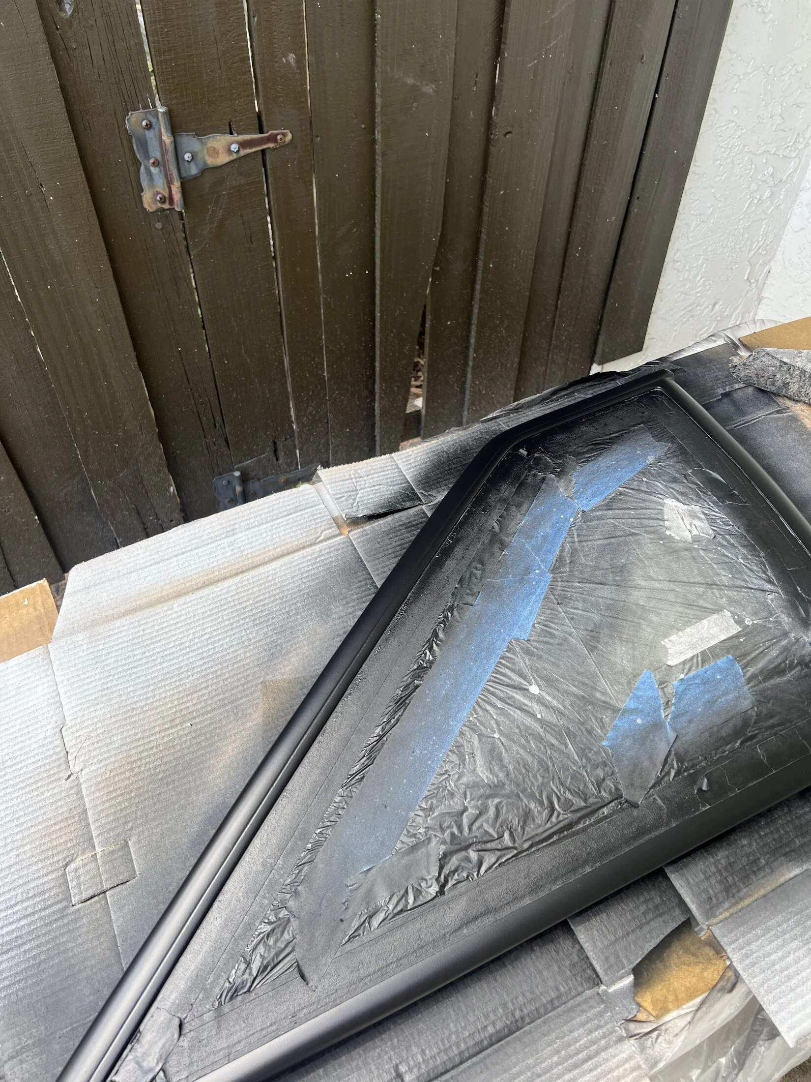

Finished up the restoration yesterday. It came out amazing. Check out the pics below. It was honestly not a difficult job and was a pretty simple process. First I used a bondo spreader to apply poly flex on top of the trim. Then I used a razor blade with some pressure to push the poly flex into all of the cracks. Then once that dried I sanded the poly flex away with 180 grit sandpaper until it was back to the window trim and all the poly flex that remained was that which went into the cracks. After that I primed it with sem flexible primer, three coats. Then I sanded down the primer with 600 grit sandpaper to smooth it down and remove any remaining imperfections. Finally I hit it with sem trim black.
This is the end result!

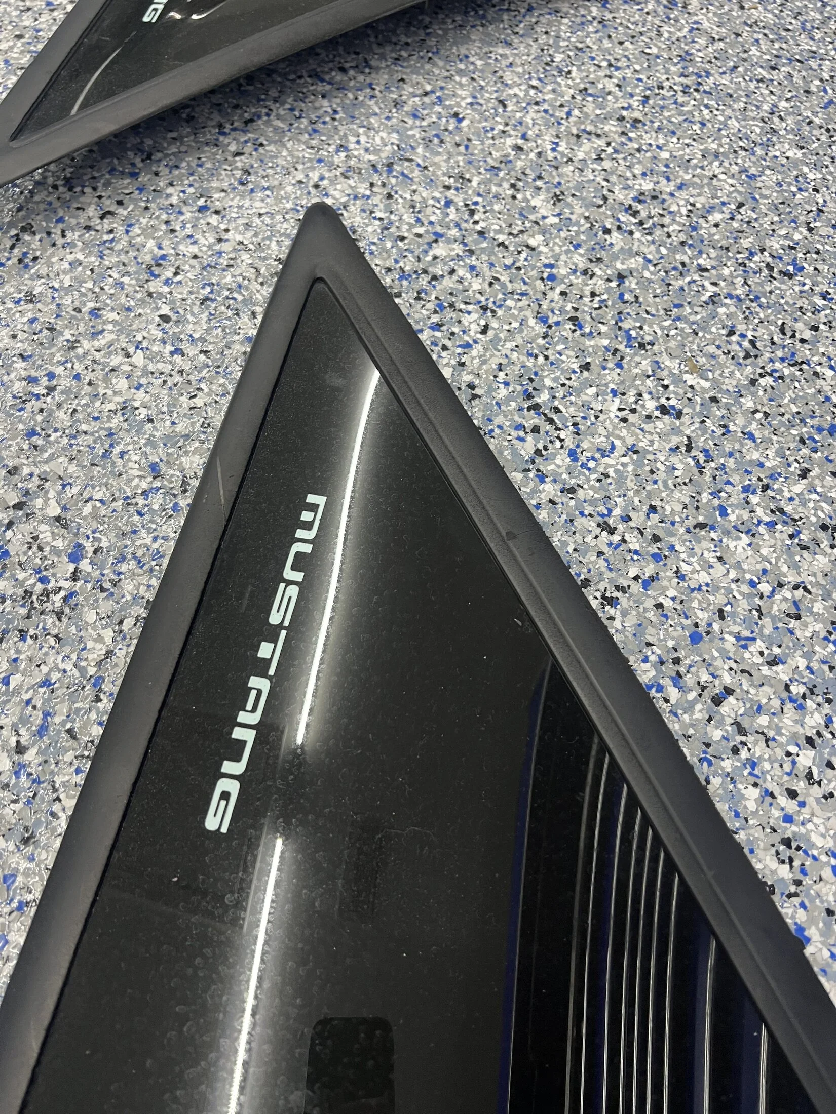

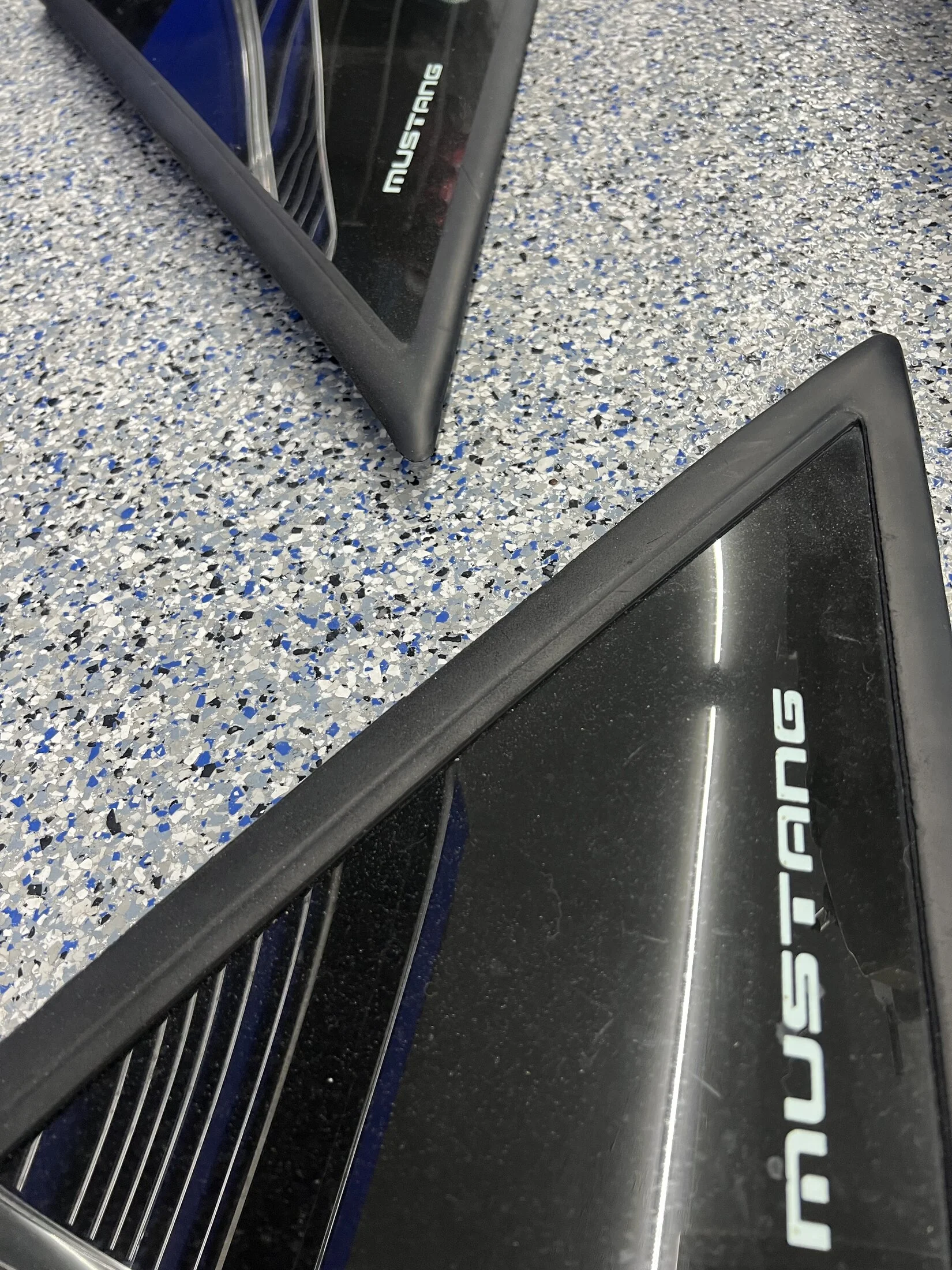

I was looking through some ads and it seems notchback DCR quarter glass has the mustang logo and the scott drake hatch quarters do not.
I'd be curious as to why. Licensing issue?
