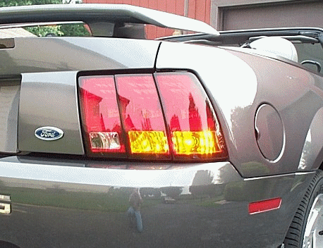

Are you having problems with the flash rate on your turn signals because the stock flasher is (falsely) taking the low current draw of the LED's to be a burned out bulb?
If so, you might want to simply try a different flasher like the Cobra one, PN F67B-13350-BA. The stock Mustang flasher expects to "see" the current draw of three regular bulbs. The Cobra one expects to "see" the current draw of only two regular bulbs. That difference might help you when using LEDs.
Otherwise, you could try opening up and custom modifying your stock flasher to work more correctly with the different current draw.
