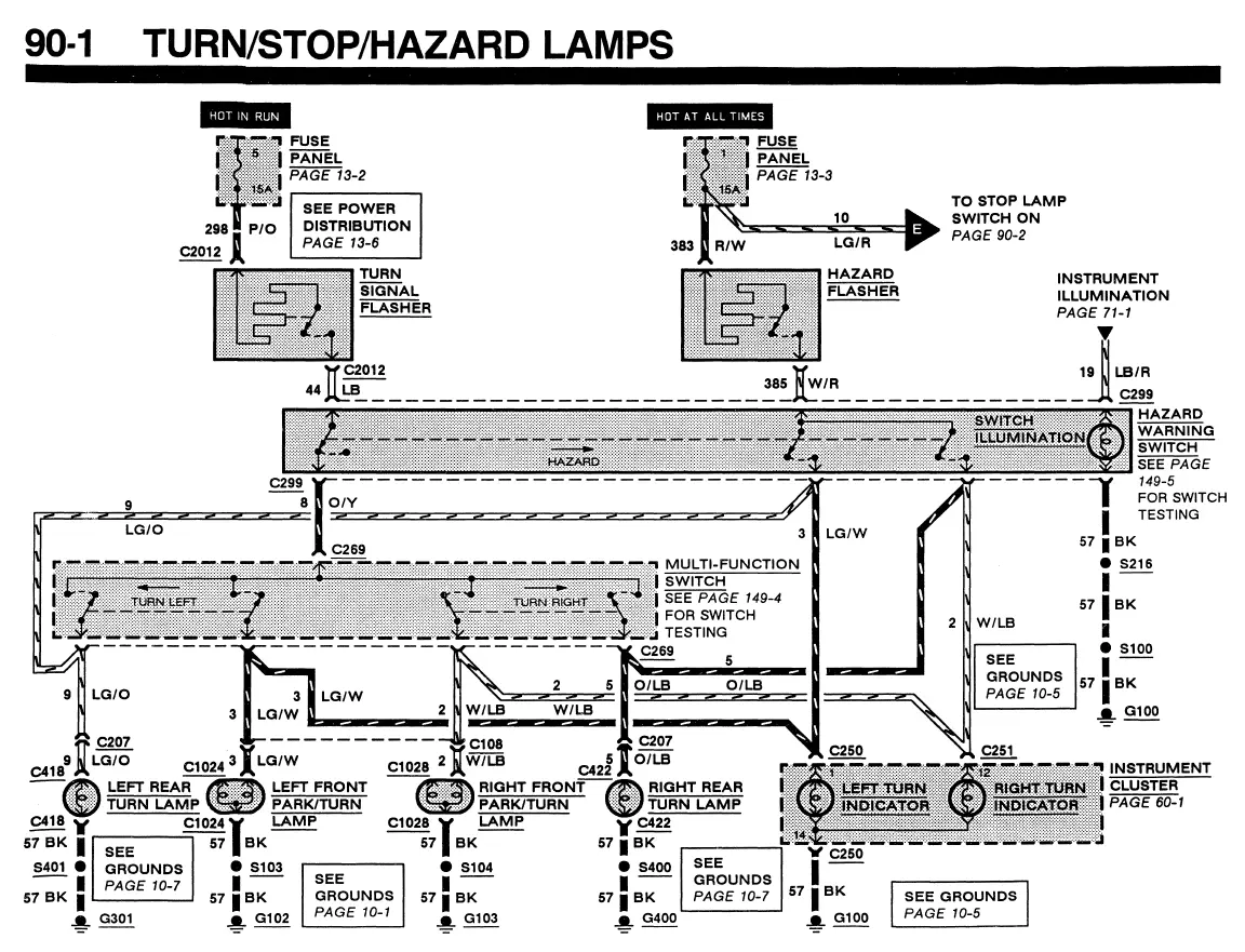

Hey all. Need some help - my hazards dont work. I changed the fuse, both turn signal and hazard relays. Replaced the switch. Replaced the pigtail for the switch. Replaced the multiswitch. And still. NO Hazards!
What could I be missing? Any advice ?
Turn signals and hazards have two different relays and two different fuses
