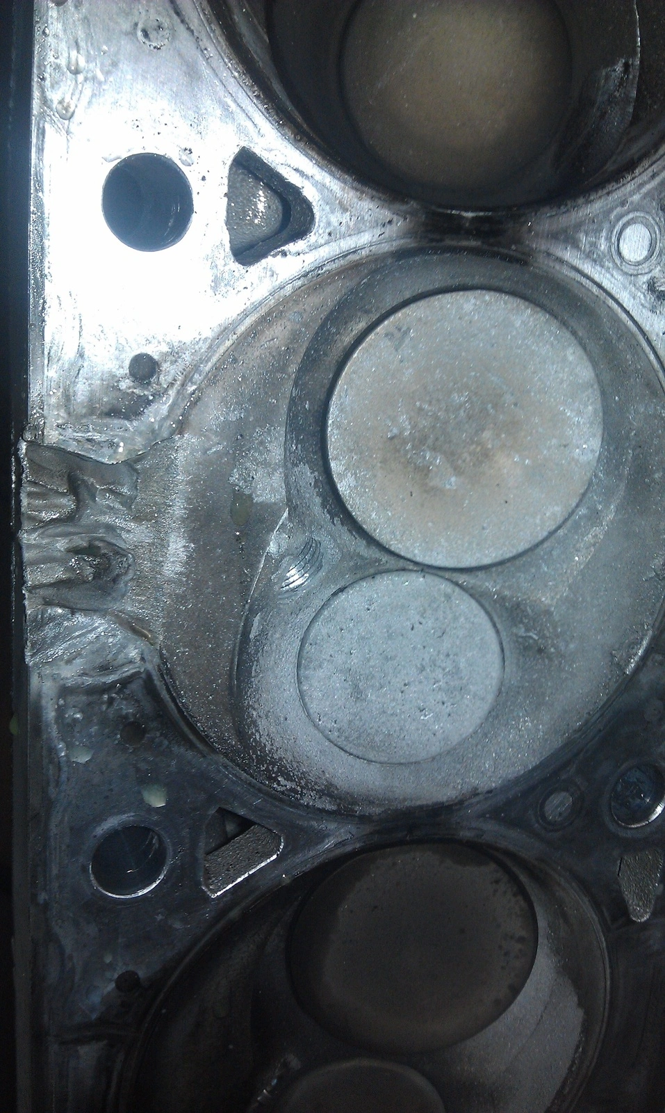

Welp guys....Finally tore off the passenger side header to replace what I thought was a blown header gasket. Exhaust gasket looked fine, but started cleaning up the surfaces to use some copper rtv in place of a new gasket, as recommended by many others who are boosted. While I was cleaning the surfacrs, I saw a small puddle form under the car. Upon investigating, I found this...

. If this is mostly a driver then I wouldn't hesitate to just use a standard gasket. While I have done just one side I would recommend you do both. I mean another hours work for piece of mind would be worth it IMHO.
