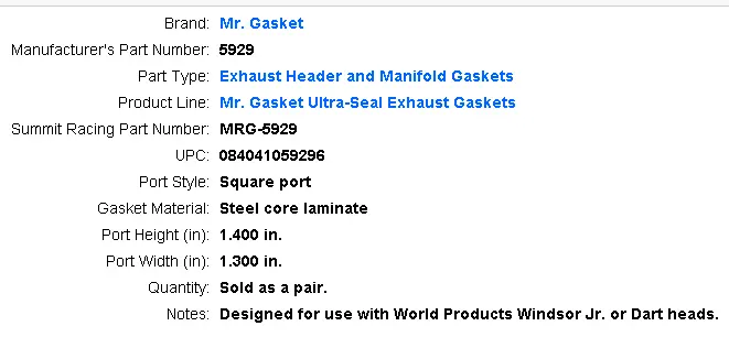

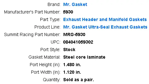

I want to say 5930 . Autozone has Always had them on the shelf .
And I'm 8.2 302 based dart block
Reactions: stang89bidges
I just saw this too, do you have Dart heads? Or Dart Style heads?
5929=Dart port style and size
5930=Stock port style and size
