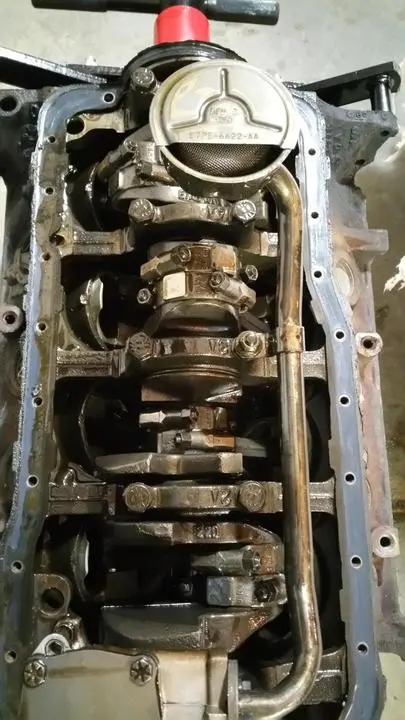

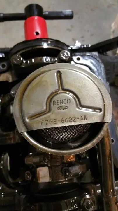

If the pickup is fairly new and not clogged, reuse it. I don't know what pan gasket that is, but I use the Felpro 1 piece blue rubber one with steel reinforced bolt holes. The same material as the VC gaskets I use. While you are at it. replace the rear main seal with a Felpro one and install the stainless steel sleeve.

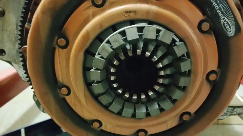

For the clutch disc, inspect it to see if any springs are loose, if the surface material is worn, damaged, burnt. Think of it like a brake pad. Also inspect the flywheel and pressure plate for signs of cracking, warping, discoloration from heat(hard use) and straightness.

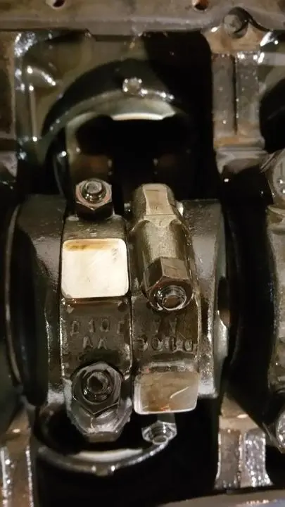

Head bolts are 100% tty, rod bolts arent, and main cap bolts shouldn't be. Remember, the head bolts also have to maintain a sealing surface where a main or rod bolt, at a lower torque value, dont.

Did the heads of course 3 times but other than that she's all factory inside. I think I want to reuse the pickup but replace the pump. Keep the rod bolts but replace the main bolts. Replace all the main bearings and reuse the cam bearings if they check out ok.

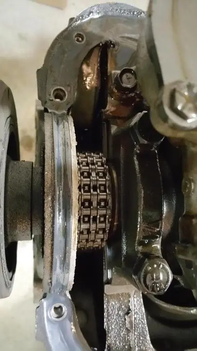

Oil galley plugs and freeze plugs I will replace. Reuse the damper. With so few miles I really want to reuse the timing chain of I can.
What do you guys think? I plan on tearing her down in a couple years for upgrades so I think I will be ok with these decisions just getting her out on weekends for 2-3 years right?

Actually, your rod bolts see more stress that the mains, so if you want to change something, I'd reverse your thinking there.. and timing chains are cheap, and you have used 3/4 of the life of yours. I'd change it. I've reused pickups after flushing well and never had a problem. I did changed them after bad failures that put junk in the pan, but that's not the case with you.. I'd think you're fine there.
