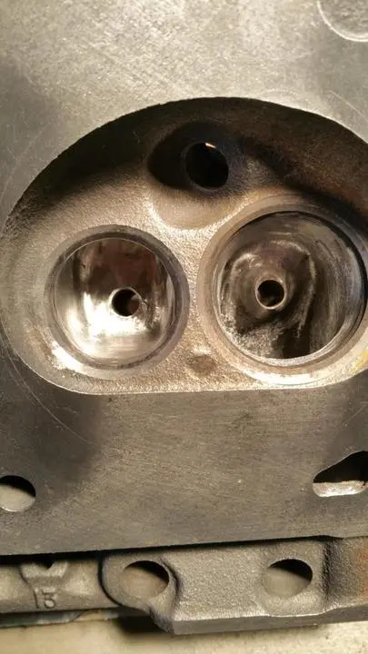

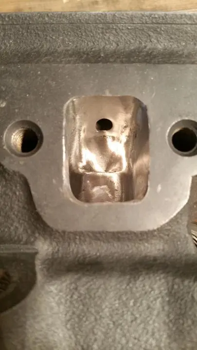

I'm gettin there. I have about 16 hours into these heads right now.
Before and After exhaust port
Intake an Exhaust

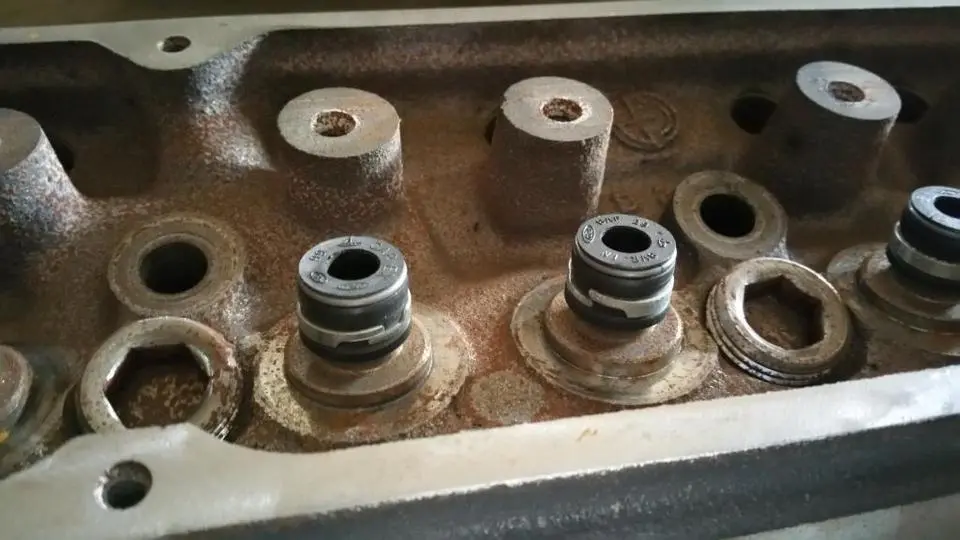

There was a little plastic retainer on top of these:
It was around the valve stem holding it in. Do I need to replace those plastic retainers? I can't find them anywhere.....
Those aren't retainers, they're valve stem seals. If you're upgrading springs, the tfs kit comes with new ones, or theyre available individually as well.

Above the seals I show in my picture we're the little plastic washers that were around the valve stems. They were so brittle they all broke off during disassembly.
Those little plastic washers were what I was asking about.

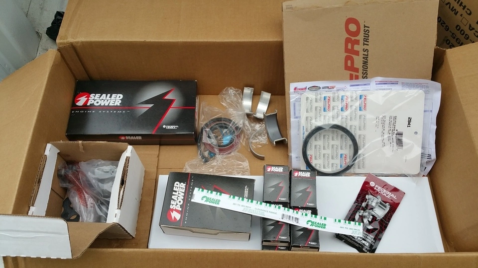

Brown truck.
Reactions: TOOLOW91 and A5literMan
