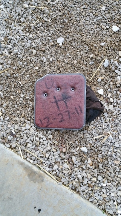

I recently(December) bought a 97 Dodge RAM, 5.9L Magnum, 22in aluminum rims, limited slip 2 wheel drive, 4sp auto. It's my new daily driver :crazy:, love it. The mechanic side of me normally would never have let it go this long before I tore her apart looking for all the hidden secrets the PO lied about but the weather has me by the balls and of course my stang takes precedence even if it is a cool big block truck on 22's with blue racing stripes... :rock:
Anyways this weekend was beautiful so I decided to camp out at the garage all weekend and get my heads finished on the stang and maybe do some small maintenance to the truck. Saturday morning I wake up and start draining the oil in the truck, then I flush the coolant system and find tons of rust... So I replace all the heater hoses and am doing a 3 day flush. Then I decide to drop the tranny pan and change the ATF and filter. I ended up adjusting the bands while I was in there. Turned out to be a non-stop weekend of work.
I basically spent the whole day on the Dodge. Then as I was putting all the old fluids from oil change in old jugs I layed the ATF filter to the side and as it drained itself in the sun it revealed a nice little message that I was pretty happy to see, wish I would have thought to do this myself!
Here's a picture.

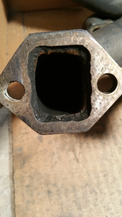

Here are a few pics I took tonight.

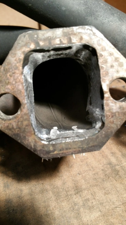

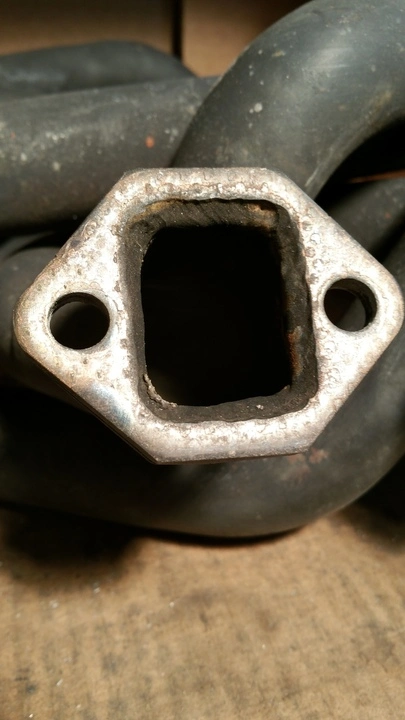

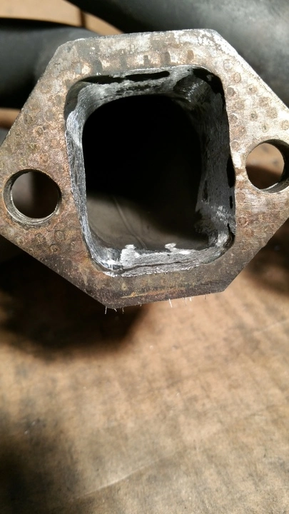

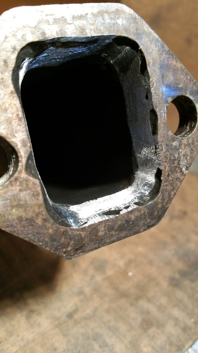

MAC shorties. Pretty nasty thick welds.
And here is the after. I didn't want to take to much of the welds away so they may not look all pretty but I ended up taking all of the lip on the insides away and smoothing them down pretty good. These pics are only after I used a carbide bit and 80g sanding stone.

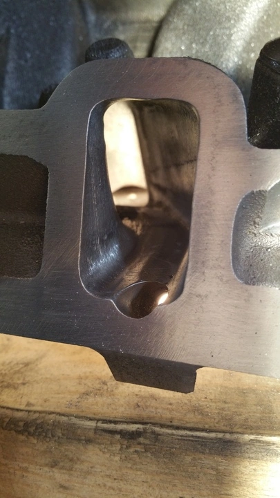

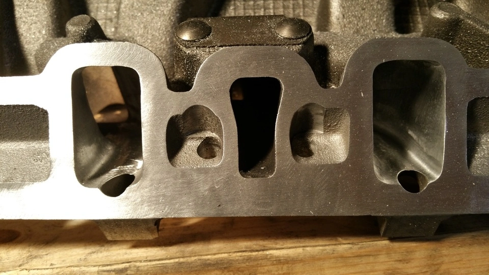

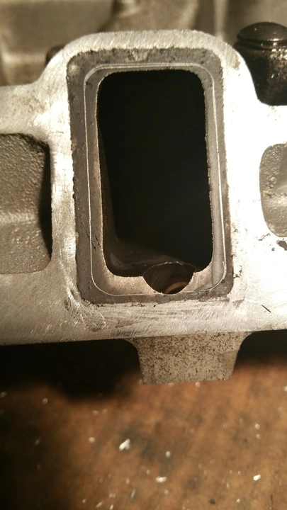

More progress tonight. Working on my lower intake. Got the "head" side ports completed. I didn't take too much out of the port opening to make sure I didn't go larger than the heads port opening. They are close though so they should either match up nicely or be a hair smaller. I'm still taking into consideration that the "feeding" port opening should be smaller than the "receiving" port opening.
Here are a few pics. I didn't get very good shots of the before...
Before:
One of the places I removed the most material was the inside bank that @tmoss talked about in his write-ups. Making the opening a "straight shot" rather than a blocked pathway results in a better flowing port. At least that's how I understood it to be.
After:
