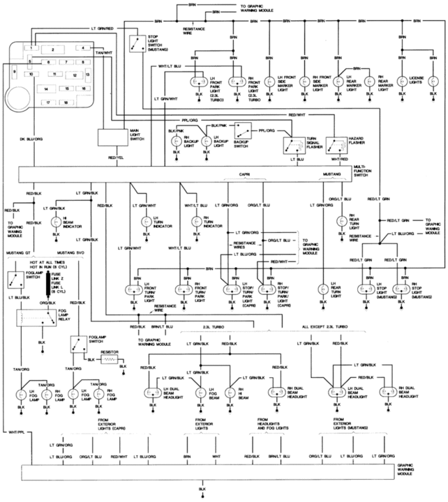

Hey folks,
After my headlights quit on me during a recent commute. I purchased a new headlight switch due to previous problems with the headlights not wanting to operate.
I replaced the headlight switch and the lights would still not operate, now with the new switch, the parking lights would not work either.
I then bought a new ignition switch and turn signal switch (needed one anyway) to no avail. I then noticed that four wires where pulled out of the cannon plug for the headlight switch.
Problem.....I don't have a wiring diagram to connect the four wires properly.
Does anyone have a wiring diagram for the headlight switch for a '86 Mustang GT.
I'm in dire need of a wiring diagram. My only other choice is to find a '86 Mustang in a junkyard and cut the wires leading into the cannon plug...That can take days/months/who knows?
Thanks,
