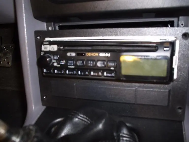

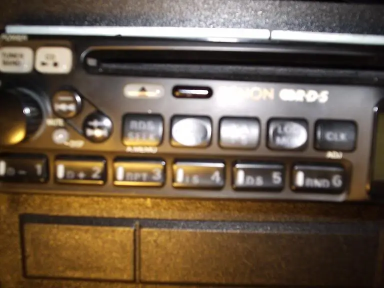

get me a pic of the headunit. you do realize a denon headunit is $$$ right?

  • Jul 19, 2007
No, actually I didn't
Sorry they're blurry, thanks for the help.
superspec
Aug 14, 2006
78
Jul 19, 2007
  • Jul 19, 2007
denons newest highend headunit retailed for around 3k. most anything denon though is higherend.
