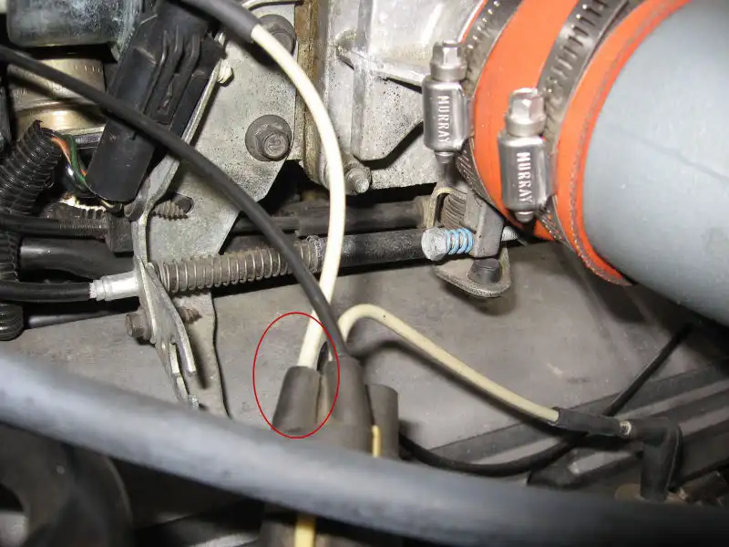

I may not be exactly clear what you mean by "find the other half of this plug", but here's a picture of where the vacuum line from the EGR valve goes on my car. It's the one circled in red.
Jeff

Its the part right below the circle, its the other half of the plug that the 4 vac lines go into.
http://img282.imageshack.us/img282/3540/egrlineom6.jpg
I made it clearer there.

That should come off of 3 solenoids mounted to the rear of the passenger side strut tower.

Thanks, ill go look for that. I've looked at it several times before but I couldn't figure out if it went there, ill go look again then.

Ok so I found that and plugged it in, it was stuck behind one of the solenoids, but when I started it up it had a huge surging idle which of course if from the snapped vacuum line I am assuming. But after letting it run and revving it, smoke came out from under the hood, and when I shut it off I went to check and it seemed to be coming out from under/around the headers.
I am pretty sure that the vacuum leak is because the fuel line tubing is getting pinched due to the vacuum so I am going to go out and cut a much shorter piece and attach the two back together. I have no idea what the smoking problem could be though, my only guess is that I didn't tighten the headers enough. I don't have a torque wrench, nor do I know the specs they are to be torqued to, but i tightened them down as much as I could with an open-end wrench.
