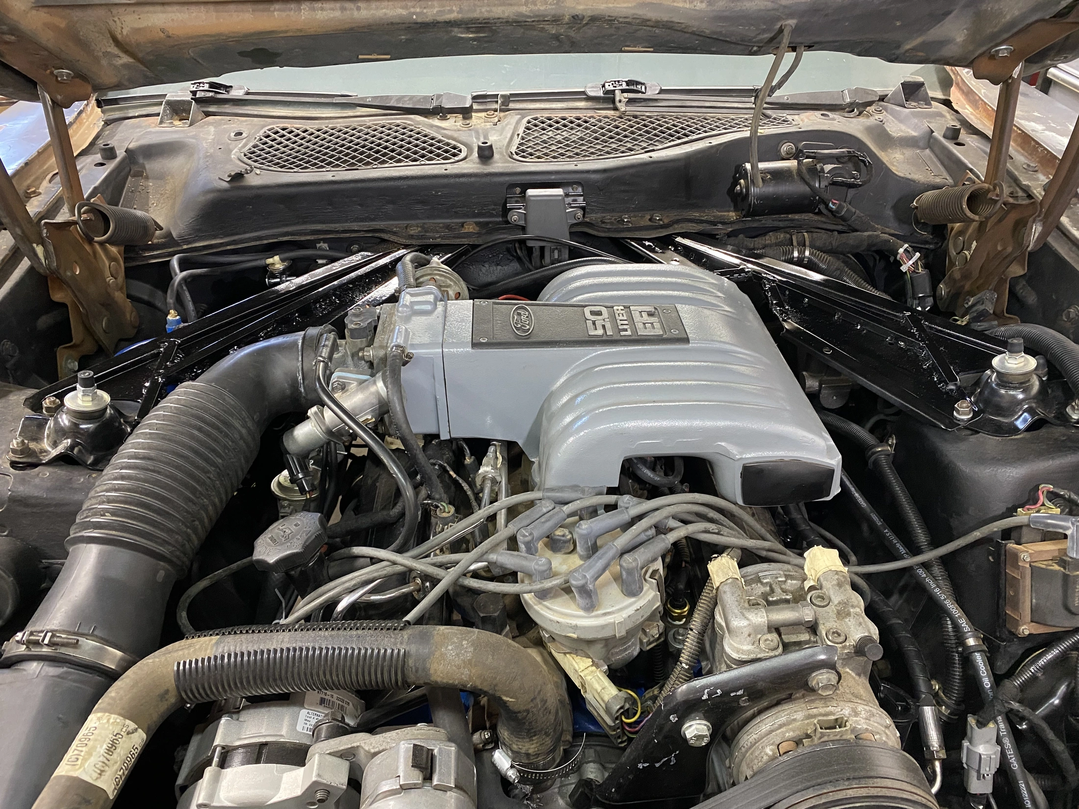

I’ve got a question regarding relocating the vent tube that goes from the throttle body to the valve cover. The engine is a 5.0 from an 87 TBird (throttle body on passenger side) and it’s installed in a 73 Mustang. The metal 90ish degree tube that exits the throttle body is in conflict with the hood. Has anyone either relocated the tube to a different location or is there a throttle body that will work with my linkage that has that vent tube lower? I do not have photos of the hood to tube conflict, yet. I will next month when I get back to my car. Was just hoping this is a know problem with good solutions. Thanks for the help.
). Just drill a hole and install a fitting or barb.
