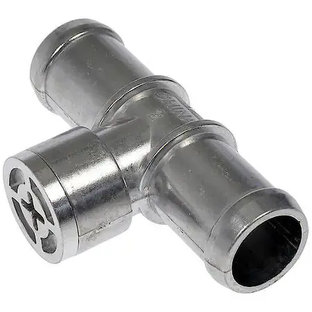

I'm going to install a little bleeder junction in one of the heater hoses and report back with results since I'm curious and I have extra hoses.

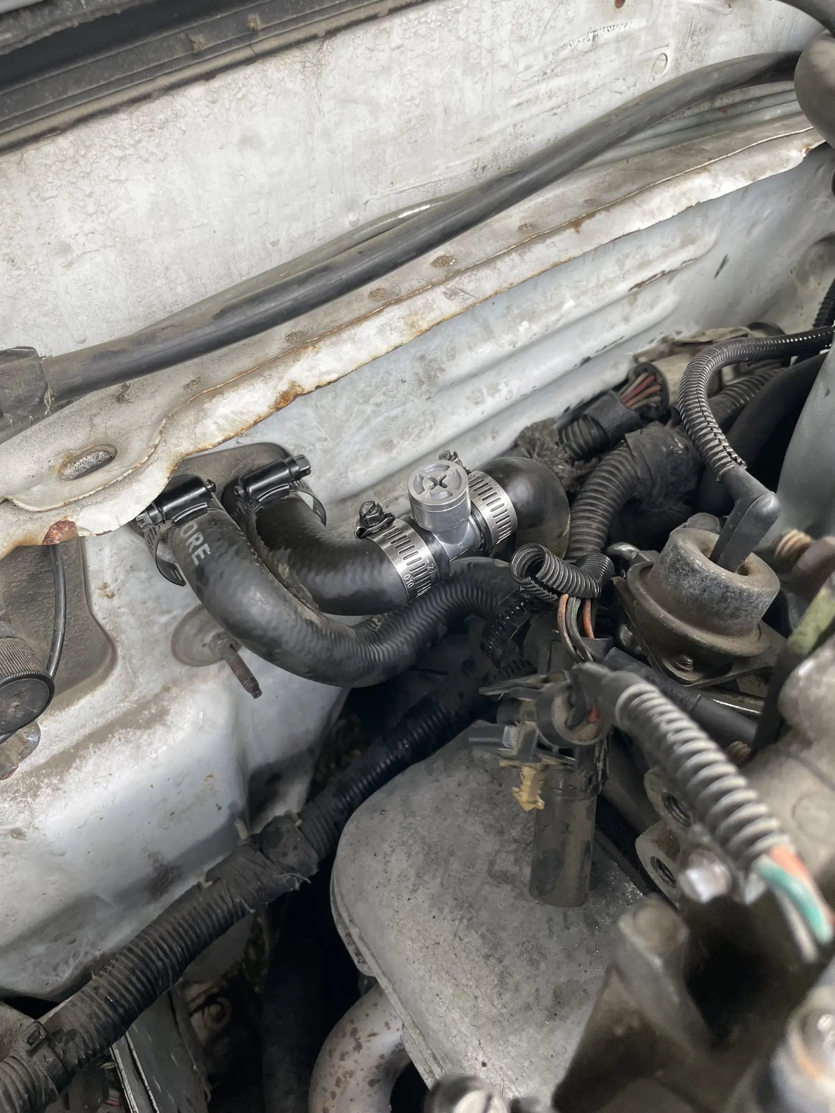

Okay here was my solution:
When I cut the hose open almost no coolant came out which indicated to me that there was a lot of air in there. Bled the cooling system again after installation and the heat blows much hotter now.
I think it would have worked even better if I put the bleeder on the outlet hose instead of the inlet hose but the shape of the hoses made it a lot more convenient to use the inlet. Might mess around with it some more in the future to move the bleeder to the outlet but I'm pretty happy with the results.
