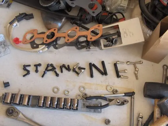

how do you take them out. is there a secret i dont know. i think you would just use like a 5mm on the end then take it off but when i tried i broke the socket. it was a cheap socket. if i get a craftsman should i have better luck. i wanna take them out cause i got stage 8 locking bolts that i wanna use. thanks guys
