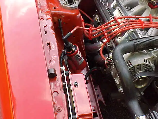

ExplodingGopher said:
bingo..... jet hot coated headers/ceramic...
I used jethot to coat my kooks headers. The stuff works awesome. After shutting the motor down when it's hot you can touch the headers after about 10 minutes of cool down time. Plus they look hot. not a great pic.
ExplodingGopher
Jun 11, 2004
517
The mistake on the lake (Ohio)
Dec 28, 2005
  • Dec 28, 2005
my hooker sc headers are the painted versions, i couldn't spend ~$100 more for jet hot, no money, but the paint right near the exhaust ports burned off within the first few seconds of first time starting. I almost crapped my pants seeing all that smoke lol.
You can see it in this picture, damn header paint.
