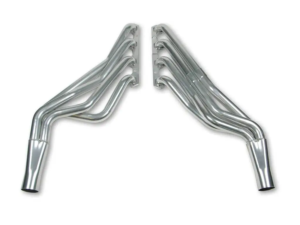

Hooker super comp from Cassic Auto Reproductions
Look very nice but almost 900$ Can probably find a non coated set cheaper some where else.
Don't think they will get along with C6
